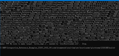

Then I follow the steps to executed it :5.3. Build The Bootloader ,but when I config the configuration.bat
about cygwin64, it reports errors:'C:/cygwin64/bin/make.exe' is not recognized as an internal or external command or operable program, I have downloaded the latest package about cygwin.
Then I search the cygwin64/bin, it do not have make.exe
I found make.exe in the path:C:/NXP/S32DS.3.4/S32DS/build_tools/msys32/usr/bin
So I replaced it, it reports erros.
how should I do to build the bootloader?

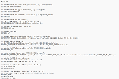

I uploaded the configuration.bat and launch.bat, please help me, thank you.

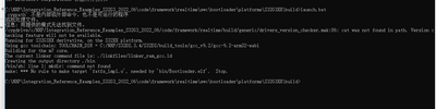

The error it shows at the end:
Seems related to the "bin" folder not existing. There seems to be a bug with the "lanch.bat" which does not create the folder in which the binaries will be put, it expects for the folder to already be available. Help us creating the "bin" folder on the same path as the "launch.bat" is being run, to verify if you can continue the build.
As for the Cygwin make.exe, it seems that Cygwin does not have the make plugin installed.
Please, let us know.

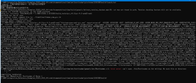

I set up a new folder: bin, then  it build next steps, but it still reports errors:
I reference the steps like that:
I  wil show you the configuration.bat:
please help me to fix it.

We are not seeing the same behavior as the one you are seeing.

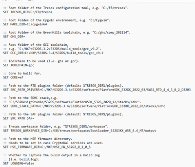

We are seeing that under your "configuration.bat" file you are linking your workspace to the one provided under the "Integration Reference Example" folder. This should be true only if you did not set the "Copy projects into workspace" flag when you imported the project into Tresos.
If you did have the flag set, you need to change the path to point into:
"C:/EB/tresos/workspace/Bootloader_S32G3XX_ASR_4.4_M7/output"
Or the one similar to your EB Tresos installation path. For our specific case, we did have the flag set, hence the path needs to be as the one shown above.
Aside from that, we are not seeing anything different from the "configuration.bat" that we are using (aside from some paths that we did not set, like SAF and HSE).

Ada_Lovelace
Hi,All
I set path:C:/EB/tresos/workspace/Bootloader_S32G2XX_ASR_4.4_M7/output
it still reports errors.
I will upload the workspace file and other files, please help me to fix the problem.

Daniel-Aguirre
There are plugins that need to be copied from the Integration Reference Example to the plugins folder of Tresos. Can you verify if changing your RTD path to be the one under Tresos changes anything? Should be something like:
"C:/EB/tresos/plugins"
Confirm that the path exists on your computer, if not, modify it to represent the one available on your computer. Also, verify that the RTD plugins are available under that path.
As for the SDHC stack, v1.0.1 is the one specified for your specific release, so we don't see any problem with this. Just, confirm that your stack is installed on the path you have provided.
Again, seems odd that you are getting this error. We do not see anything on regards of that error when we start the build process.
Another option is to delete the "bin" folder and creating it again, to erase any possible issues from the previous build.
