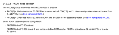

I am trying to boot the S32G-VNP-RDB3 board using the serial RCON mode to avoid using the DIP switches on the board.  As mentioned in the S32G3 Refernece manual, Serial RCON requires an external serial EEPROM that communicates with the chip via I2C. I want to use an external MCU in my design to mimic the EEPROM.
As mentioned in the document, I have set the RCON[8] pin to high using the SW5[1] using the DIP switch on the board.

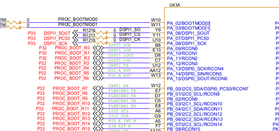

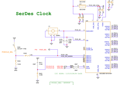

As the I2C port required for RCON serial boot (RCON[7] and RCON[8] connected to I2C0) are not exposed by the board, I have soldered wires as shown in the attachment to the two open ports connected to the SerDes Clock as they are not used by it. I verified that I2C0 is required by the RCON pins following the schematics.
I have not changed any of the other DIP switches and left them in their default configuration.  Now, when I connect a logic analyzer to the I2C0 pins that I have soldered, I get nothing when the S32 boots. I verified that the I2C line that I soldered work as they show data on them once the S32 boots in normal mode.

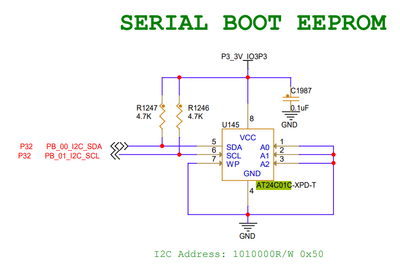

1. The reference manual mentions that the EEPROM or the MCU in my case needs to act as a slave with the address (0xA0) but the Serial EEPROm in the schematics show a different address (0x 50). Should I use 0x50 as the I2C address for my MCU?

4. AN13456 mentions that RCON[8] and RCON[9] need to be used for this mode which is clearly different from what is mentioned in the S32G3 reference manual. Which one is correct?

2.The RCON8 and RCON9 mentioned in Document AN13456 should represent RCON[7] and RCON[8] respectively. From the content of the manual and the schematic diagram, it can be determined that they are RCON[7] and RCON[8].
3.The I2C0(PB_00/PB_01) has connected to the AT24C01 EEPROM device on S32G-RDB3.

The first question. I think the 0xA0 mentioned in the manual is the write address in the 8-bit address format, while the 7-bit address of the actual device is 0x50. The two should be equivalent.

Hi @Joey_z following up on the EEPROM that is on the S32G3-VNP-RDB3, the schematic shows that it is not available to be used through the OS as shown here
The Pin mux needs to be changed for I2C0_SDA PB_00 and I2C0_SDA PB_01 to be used with I2C0 as it is used by the CAN and UART0 interface. The same is confirmed through the OS
However, this still does not explain why the Bootrom of the S32 does not start the I2C communication on I2C0 when it starts to boot.
