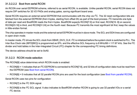

To be able to boot from SerialRCON I recommend you check AN13456 [page 6, S32G3 Boot Process, Rev. 1, 02/2023]
You can also get more information in the S32G3 reference manual [page 1319, S32G3 Reference Manual, Rev. 4, 02/202]:
This means the 32bits used as boot configurations need to be already present in the EEPROM.

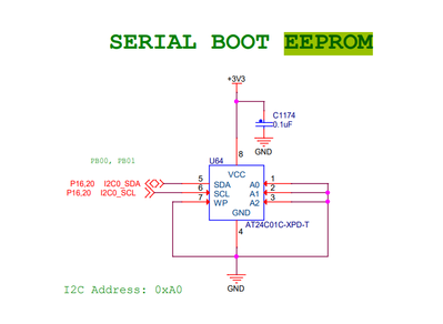

If it's possible I can recommend using EEPROM AT24C01C-XPD-T, which is used in the EVB3-Board which supports S32G3 chips.

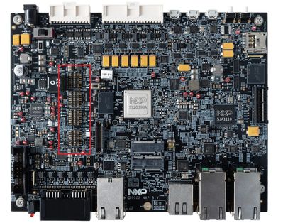

alejandro_e
Hello @piaochunri ,

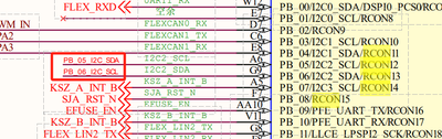

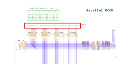

I’m assuming you are using the RDB3 board. Then the 32 bits (0 – 31) you see in the excel file represent the 4 dip switches present in your board:
You can check the schematic to see the order of the bytes [page 32, S32G-VNP-RDB3, SPF-53060.pdf] available in deseing files section of the S32G-VNP-RDB3 product page:
You can check the User Guide to learn more about the different switch configurations [Starting in page 3, Chapter 3, S32G-VNP-RDB3 Switch Setting, S32G-VNP-RDB3 User Guide, Rev. 1.0, 03/2023] available in de documentation section of the S32G-VNP-RDB3 product page:
Let me know if this information solved your question.

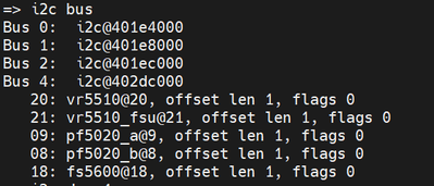

We are debugging a self-developed board with S32G399A. And our board only supports bootconfig through serial RCON not through parallel RCON. I want to known how can I set it.I have tried some commands during u-boot step.But I am not sure it is useful.

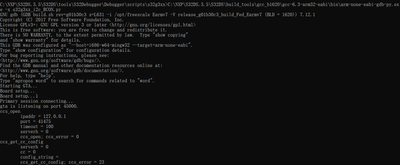

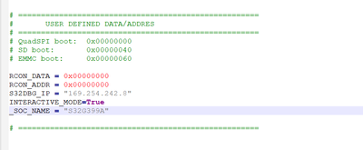

Yes.We are debugging a self-developed board of S32G399A.The scheme of boot mode part is referred to S32-VNP-RDB3. I was debugging Acore and the version of bsp is 40.0.And I followed the link HOWTO: Program Serial RCON using S32 Debug Probe S32G2xx - NXP Community t o debug it.
But when I runned the python script it could not pass the initialization whether I inserted the SD card or not.The result seems the same. What should I do?Thank you!
4,304件の閲覧回数
piaochunri
I have sovled the problem after I set the host name of s32g debug probe and I can config the EEPROM now. Thank you!

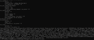

piaochunri

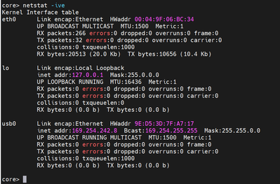

Thank you!Yes,I have read these documents.We are debugging a self-developed board of S32G399A. The designed scheme of boot mode is referred S32G-VNP-RDB3(RCON12 and RCON13).I also referred the link HOWTO: Program Serial RCON using S32 Debug Probe S32G2xx - NXP Community to debug the EEPROM.But it stopped during initialization.My A core bsp  version is 40.0.
I used S32 debug probe.Is it necessary to connect the debugger to my laptop through ethernet or USB connection is ok?The info of probe is as follows. And I runned the python script.It resulted in error.What should I do?Thank you!
