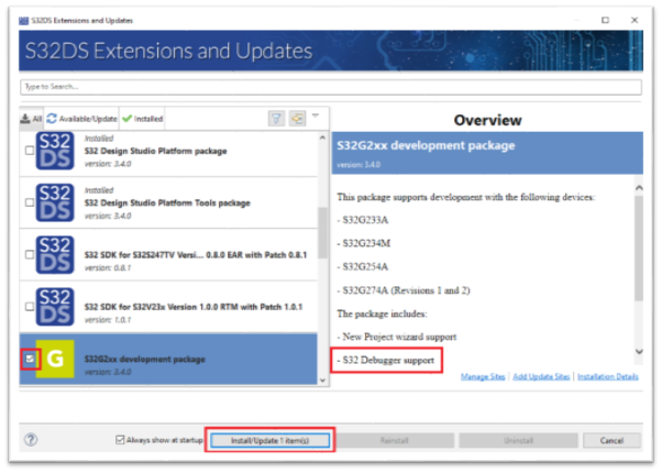

  1. Install S32 Design Studio IDE
  2. Install the Development Package for the device you are debugging. This is important as the S32 Debugger provides access to the EEPROM programming capabilities via I2C of the S32 Debug Probe.

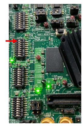

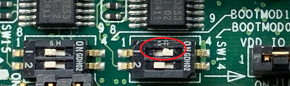

  4. Set BOOTMOD pins to boot from RCON
  5. Set BOOT_CFG[8]=1 on the S32G-VNP-EVB, for serial RCON mode
    VNP-EVB shown here with switch BOOT_CFG[8] = 0
    See the EVB documentation and device reference manual for more details.

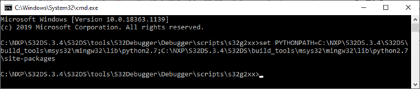

  1. Open cmd window to the S32 Debugger folder where the device-specific scripts are located.
    C:\NXP\S32DS.3.4\S32DS\tools\S32Debugger\Debugger\scripts\s32g2xx
  2. Set Python path so correct version is used (if not already set in env vars)
    set PYTHONPATH=C:\NXP\S32DS.3.4\S32DS\build_tools\msys32\mingw32\lib\python2.7;C:\NXP\S32DS.3.4\S32DS\build_tools\msys32\mingw32\lib\python2.7\site-packages

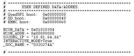

  3. Edit the python script to adjust the value to be programmed to RCON, s32g2xx_i2c_RCON.py. Note: The listed examples show only the minimum values required to configure each of the external memory types. Additional settings may be required for your specific application.
    1. Adjust the RCON_DATA for the configuration you wish to program.
    2. Do not adjust RCON_ADDR.
    3. Adjust the S32DBG_IP for the IP address of your S32 Debug Probe.
    4. Adjust the INTERACTIVE_MODE
      1. Set True, if desired to be prompted to enter RCON_DATA
      2. Set False, if desired to have script automatically enter RCON_DATA, based on the value set within the file.
    5. Adjust _SOC_NAME as appropriate for the specific S32G2xx device you are using. The valid options are defined in s32g2xx_context.py.

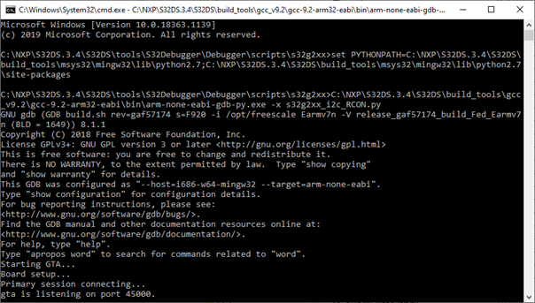

  4. Enter the command to start GDB, passing in the RCON Python script:
    Windows OS:
    C:\NXP\S32DS.3.4\S32DS\build_tools\gcc_b1620\gcc-6.3-arm32-eabi\bin\arm-none-eabi-gdb-py.exe -x s32g2xx_i2c_RCON.py
    OR
    C:\NXP\S32DS.3.4\S32DS\build_tools\gcc_v9.2\gcc-9.2-arm32-eabi\bin\arm-none-eabi-gdb-py.exe -x s32g2xx_i2c_RCON.py
    Linux OS: arm-none-eabi-gdb-py -x .\s32g274a_i2c_RCON.py

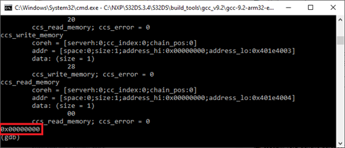

  5. If everything worked properly, then the value you programmed will be displayed to the screen.
  6. To exit GDB, enter 'quit'.
