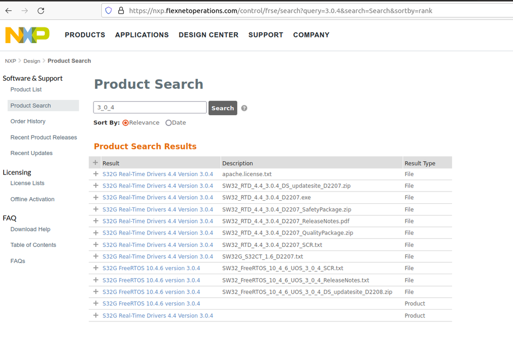

nxf92355
Version 4.7 relies on RTD 3.0.4 .   It is available on flexera site
Regards ,
Tushar
2,576 Views
jianqun
I can't see IPCF4.7 version in my account. At present, our S32G274 is a new project, which BSP version do you officially recommend to use, BSP35 or BSP33
