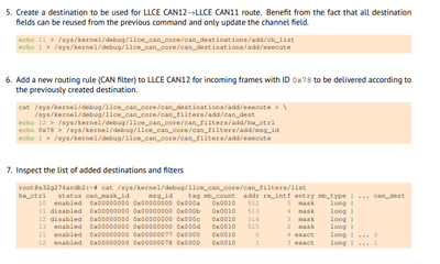

Please refer to the chapter 12.3.5.1 CAN2CAN demo of the BSP User Manual.
There is an example adding a filter with a custom msg_id.
[Page 104, Linux BSP 42.0 User Manual for S32G2 platforms] 

Yes, this is the interface I'm having trouble with. I have some questions about that example
First, how do I set up the filter to communicate with the host linux system? How do I configure the lice_can_destination to not use a different CAN interface?
Second, if I were to use another channel to achieve the same, and I set opt_host to I, then the first message behaves as expected, but then no messages get forwarded, and I start getting bus errors after 16 messages
15,318 Views

cat /sys/kernel/debug/llce_can_core/can_destinations/add/execute > \
/sys/kernel/debug/llce_can_core/can_filters/add/can_dest
echo 0x7F0 > /sys/kernel/debug/llce_can_core/can_filters/add/can_mask_id
echo mask > /sys/kernel/debug/llce_can_core/can_filters/add/entry
echo 14 > /sys/kernel/debug/llce_can_core/can_filters/add/hw_ctrl
echo 0xe > /sys/kernel/debug/llce_can_core/can_filters/add/tag
echo 0x10 > /sys/kernel/debug/llce_can_core/can_filters/add/mb_count
echo long > /sys/kernel/debug/llce_can_core/can_filters/add/mb_type
echo 0x530 > /sys/kernel/debug/llce_can_core/can_filters/add/msg_id
echo enabled > /sys/kernel/debug/llce_can_core/can_filters/add/status
echo disabled > /sys/kernel/debug/llce_can_core/can_filters/add/opt_auth
echo disabled > /sys/kernel/debug/llce_can_core/can_filters/add/opt_custom
echo disabled > /sys/kernel/debug/llce_can_core/can_filters/add/opt_host
echo disabled > /sys/kernel/debug/llce_can_core/can_filters/add/logging
echo 1 > /sys/kernel/debug/llce_can_core/can_filters/add/execute
After executing the above command, an additional filter will be created as shown in the figure below.
You need to disable the unused filters in the filter list to prevent interference between filters. After testing, the first filter will receive IDs between 0x540~0x54F to the host, and route IDs between 0x530~0x53F to llcecan15. If you need a CAN frame to be received by the host and routed to another channel at the same time, opt_host enable of the corresponding filter is required.

Thank you very much, this is very helpful, I'm happy to report that the filter is added to the list as expected. However, the filter doesn't work. As a sanity check, I've created a filter that exactly replicates the default one, with a mask of 0x000000. When I do this, I get traffic on the interface before I recreate the filter, but nothing after. I don't see any values increasing in `/sys/class/net/llcecan10/statistics/` that would indicate an error.
Due to hardware constraints, I'm using different interfaces (llcecan10 and llcecan11), and normal CAN in stead of canFD, so I've needed to change the example slightly. I'm attaching the script I'm using to test this. Could you please check if I'm making some mistake, or if the behavior is indeed unexpected.
I also tried to create an exact matching filter, for address 0x77, from the example in the documentation, but the interface just stops receiving communication.
the interface is up when I check `ip link show`, and if I do `cansend 000#AABBCCDD` the interface is able to send frames correctly. It just stops receiving frames once I create the basic filter that is exactly the same as the default filter:
root@s32g274a-n4c0a53:~# cat /sys/kernel/debug/llce_can_core/can_filters/list
hw_ctrl status can_mask_id msg_id tag mb_count addr rx_intf entry mb_type | opt_auth opt_host logging opt_custom can_dest
0 enabled 0x00000000 0x00000000 0x0000 0x0010 512 15 mask long |
8 enabled 0x00000000 0x00000000 0x0008 0x0010 520 7 mask long |
9 enabled 0x00000000 0x00000000 0x0009 0x0010 521 6 mask long |
10 enabled 0x00000000 0x00000000 0x010a 0x0010 522 5 mask short |
11 disabled 0x00000000 0x00000000 0x010b 0x0010 523 4 mask short |
11 enabled 0x00000000 0x00000000 0x000e 0x0010 524 4 mask short |
Another question about the example, could you please explain the 0x7F0 values that get written to /sys/kernel/debug/llce_can_core/can_filters/add/can_mask_id for both filters?
