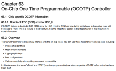

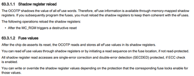

hi @ARM_Kami,
You refer to the AN14136(page 7) but that is a Bluetooth Direct Test Mode.
About the DIS_SER_BOOT fuse, you can use the OCOTP module to read the fuses.
[page 3358, S32G2 Reference Manual, Rev. 8, February 2024] 
Something to remark is the 63.3.1.1 and 63.3.1.2 about the fuses
[page 3359, S32G2 Reference Manual, Rev. 8, February 2024]
For an example program you can check Ocotp_Ip_Example_S32G274A_M7 or Ocotp_Example_S32G274A_M7, for the RTD or MCAL/AUTOSAR API respectively. Please be careful when executing the code, as you know the fuses are one time programable.
If you have more questions about this topic, please let me know.

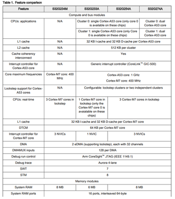

Hi @ARM_Kami,
The sw size limitations is not caused by the NOR Flash in this case, the boot process loads your sw into SRAM to run from there, so the limitation is given by the system RAM. This SRAM size will vary in the S32G model, this is mentioned as system RAM at the datasheet of the product.
[Page 5, S32G2 Data Sheet, Rev. 6, 12/2022]
The QSPI bus is mapped to can access up to an 512MB flash.

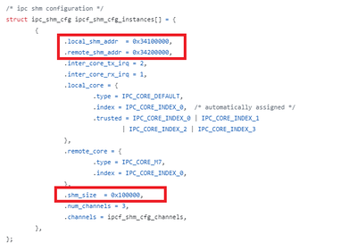

Also, something else to consider is there is some peripherals that need use of the system RAM to run
1. PFE
Some SRAM was reserved for PFE by default in the device tree of BSP, show as the following:
You can change the default SRAM memory region to DDR.
2. LLCE
If you used the CAN2ETH or ETH2Can application for LLCE, then they need to notice some SRAM allocation in the applications, usually they are arrays and could check their SRAM address with debugger such as Lauterbach.
3. IPCF
The share SRAM memory (include local remote address and their size) could be configured, default configure shown as the following:
4. HSE
The memory map HSE could be found in attached S32G2_Memory_Map.xlsx, shown as the following:
5. eMMC boot

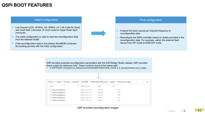

You need to find "Application boot image header" from IVT header and check its field "RAM start pointer" and "Code length" and know the location and size of your A53 application that loaded in SRAM. Make sure no overlapping between A53 and M7 application.
There's one more note about it:
Additional comments, you could check whether your application had been loaded in SRAM completely firstly through debugger or other viewer tool for memory.

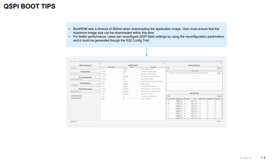

Also, at 30.13.1 QuadSPI boot [S32G2 Reference Manual, Rev. 8, February 2024] the following is mentioned:
[page 1255, S32G2 Reference Manual, Rev. 8, February 2024]
So, you need to ensure you application can be loaded in less than 500ms.
Let me know if you have more questions.

ARM_Kami
About the note in the Reference Manual (section 30.13.1.1): "... BootROM sets a timeout of 500ms when downloading the application image. User must ensure that the maximum image size can be downloaded within this time. The image size would depend on the configuration used."...
How can I verify that timeout?
Or do you have already a reference based on the code size?
Is the downloading of the application image the one from reset to load from  NOR flash into SRAM? Or from the serial flashing process?

Q: Is the DCD file neccessary? What extra config. is it neccessary?
A: No, in this case the DCD is not necessary. Your config looks to be set properly, I would focus to verify first if the problem is from booting with QSPI with the 500 ms timeout.
Q: The RAM start pointer and RAM entry pointer what are the consideration to select them?
A: At the .map file you can see the .intc_vector as you mentioned, this value indicates the location of the vector table. The RAM start pointer value can be found at the linker file as int_sram. This value refer to the memory map where is the start of the sram of the system.
Regarding to the 500ms timeout when downloading the application, it refers to the time when you reset the system and load from NOR flash into SRAM. If the image is too big and the trigger the timeout the system will reset (There is a reference code size, because it depends also in your QSPI because you can use HS200 or HS400).
To verify if this is happening you can see if the reset signal is triggered.
If is the case that you confirm that the error is happening by the timeout, an option can be to implement a bootloader you can see an example at the Application Note AN13750.

carlos_o
Hi @ARM_Kami,
An apology, I confused the HS200/HS400 modes this is for eMMC.
The information you need for the QSPI boot configuration can be found in the following documents:
S32G Quad Serial Peripheral Interface (QSPI) Deep Dive
AN13563: S32G QuadSPI Deep Dive Application note
As you can see there is some reconfiguration parameters that has given with the S32 Design Studio.
Also, you can do your own reconfiguration thought the S32 Config Tool.
To do this Implementation the DCD is not necessary.
