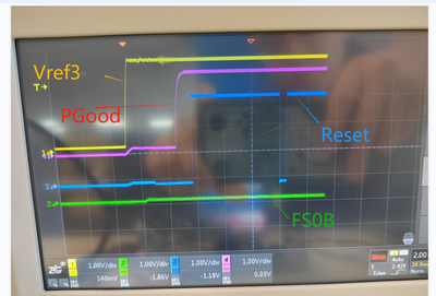

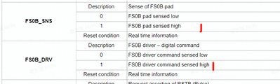

      When we start code from norflash  use QuadSPI boot ,  in our own boad .There is always a wrong RESB like the picture attatched below .The code  running well ,but The VR5510 can‘t get in stadby mode,VR5510 FSM_STATES always is ASSERT_FS0B! Which may cause that ,how can we solve this problem to release VR5510 FS0B.The VR5510 error count is always 2 .The register shows us it can't find a EXT reset signal.

Hi @GuoGuo,
Thank you for reaching out to us.
Will you share more details when you are facing the issue on boot time or on stand-by condition?
Also, please describe the impact of the issue. Is it not properly booting or having issues with Stand-by?
