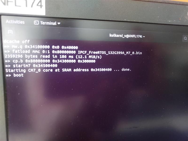

And used the following commands
# 1. Disable data cache
=> dcache off
# 2. Clear IPCF shared memory
=> mw.q 0x34100000 0x0 0x40000
# 3. Load M7 binary from SD card into temporary DDR
=> fatload mmc 0:1 0x80000000 IPCF_FreeRTOS_S32G399A_M7_0.bin
# 4. Copy firmware to M7 SRAM
=> cp.b 0x80000000 0x34300000 0x300000
# 5. Start M7 core at vector address
=> startm7 0x34500400
# 6. Boot Linux normally (if not already)
=> boot

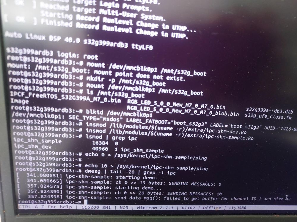

But getting an error of
root@s32g399ardb3:~# dmesg | tail -20 | grep -i ipc
[ 81.689010] ipc-shm-sample: starting demo...
[ 81.689029] ipc-shm-sample: ch 0 >> 19 bytes: SENDING MESSAGES: 0
[ 91.808767] ipc-shm-sample: starting demo...
[ 91.808771] ipc-shm-sample: ch 0 >> 20 bytes: SENDING MESSAGES: 10
[ 91.808778] ipc-shm-sample: send_data_msg(): failed to get buffer for channe2

From the information you share, you are using 4.10 on M core side, but using default images in BSP40 on A core side.
By default, the IPCF images in BSP40 is not the 4.10 version, so the code on both side does not match.
As a result, the following method may solve your issue:
1. Manually build IPCF 4.10 images on BSP40, and use it to communicate with M core side you had built.
2. Another way is to build IPCF4.9 on your M core side, and then use the default images in BSP40 to communicate.
You may choose either of the methods provided according to your own requirements.

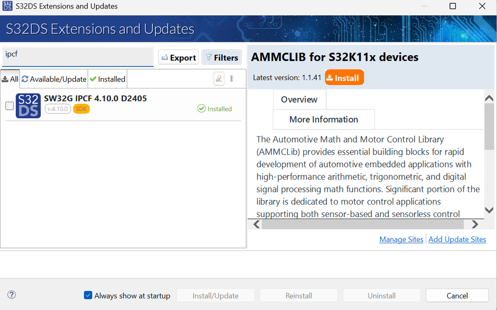

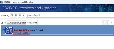

I feel sorry that still I do not see the IPCF version you used on M core side, the IPCF version may like the following:
Chenyin
2,685件の閲覧回数
Kulkarni_v
@chenyin_h
Yes I am using IPCF version 4.10.10Screenshot 2025-10-10 225736.pngScreenshot 2025-10-10 225736.png

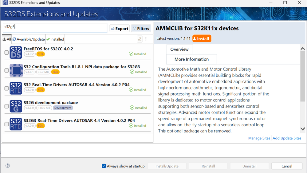

1. Which version IPCF you are using for building the M core binaries?
2. Have you build the IPCF A core side manually or directly using the IPCF modules existed in BSP 40 rootfs?
Chenyin
2,729件の閲覧回数
Kulkarni_v
At M-core side I have used above versions and I am using BSP40 downloaded from software support(https://nxp.flexnetoperations.com/control/frse/download?agree=Accept&element=3993158). I have not built it separately.
