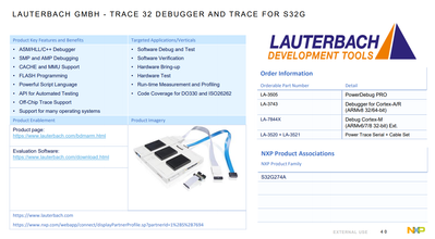

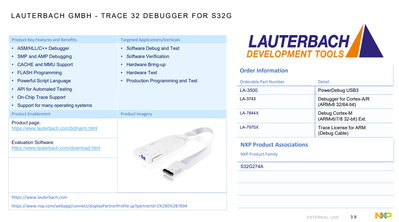

14,730 Views
Daniel-Aguirre
For S32G, we have the following information on regards of Lauterbach tools:
For which we are not seeing the specific P/N you are mentioning.
Still, we recommend sending the inquiry to Lauterbach support itself, since they will provide more information on regards of their platform.
Please, let us know.
14,582 Views
rweiss
Contributor V
Hi @Daniel-Aguirre,
the debugger setup is suitable for S32G. Some order numbers changed since these pages were created.The pages show the recommended configuration at that time, but usually older hardware will also support newer processors, by updating the debugger software.
Reinhard
