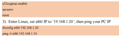

Problem description:Configure according to the 《S32G-VNP-RDB2 Ethernet Enablement Guide》,Set the IP and netmask for eth0 after entering LinuxBSP350:ifconfig eth0 192.168.1.20 netmask 255.255.255.0 ,And set the connected PC's IP to 192.168.1.10, with a netmask of 255.255.255.0 .
Then Ping and find that can't connect, Please help me, what should I do next to enable Ethernet communication? #S32G-VNP-RDB2

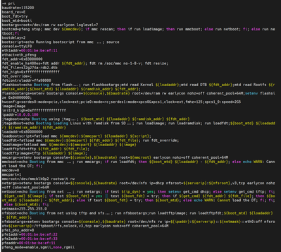

suda1684
hello,Chenyin
Thanks for your reply,
The BSP uses the version that was already installed in the SD card at the time of receipt.
The settings made in BSP are done according to the configuration in the file "S32G-VNP-RDB2 Ethernet Enablement Guide", and the corresponding configuration and pri parameters in U-BOOT are displayed in the figure below
