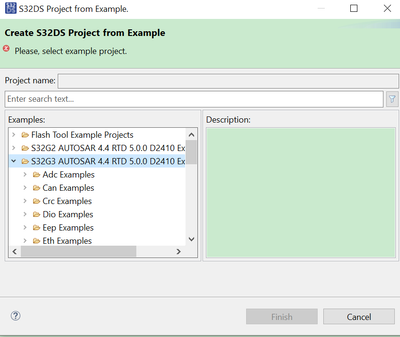

Dear NXP team,
I am facing an issue in S32DS build project from the example is not displaying [There is no reference examples] after installing all software bundles for S32G399ARDB3

I have reinstalled all the software bundles several but still not able see reference example for s32g vnp rdb3 board

Seems you were testing it with S32DS3.6.1? which is quite new, I tested it on my end based on a S32DS3.6.0 setup, and installed the RTD5.0.0 manually from the images downloaded, the examples could be created for S32G3 successfully as follows:
I have checked your log, but seems the packages installed are not fully shown from your snapshot, would you mind sharing a full picture of it, to ensure if the RTD is well installed.
