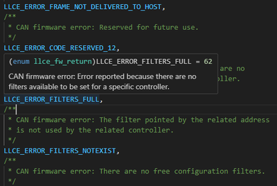

1) Where can I find the definition of ` LLCE FW error 62`
2) what could be the root cause of this error?

Thanks for your reply. Could you please check the definition of error **62** in that file, you looked at 63. I did find a file named Llce_InterfaceFwMgr.H, but it does not associate the error descriptions with numbers.

1. I'm reviewing if there is any information of how many filters can be added to the same controller. Could you please share what is the max count of filters you are trying to add to a specific controller?
2. I found the file at linux repository of NXP at the path: ./include/linux/mailbox/nxp-llce/llce_fw_interface.h
The error 62 is the following
3,775 Views

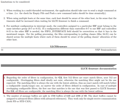

There are just 512 exact filters available for S32G2, this is 32 for each controller as we have 16 controllers. There is not a work around for the limitations. The max number of filters increase for the S32G3 product.

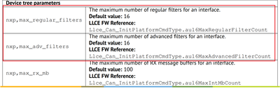

For the Linux side, it is configured in the device tree. the detail is in the chapter 12.3.6 Advanced parameters in BSP RM
the 32 limitation comes from here, so if customer want to increase filter, customer should increase the variable as below
So, my last response was wrong, there is a way to modify the max num to attach for the same HW channel.

Hey @carlos_o , Thanks for the reply. Ive been spending some time trying to get these configuration changes applied, but I'm stuck:
1) In the Yocto/BSP build tree, which dts or dtsi file do I need to modify, and which yocto recipe do I need to modify to get the configuration change in the device tree.
2) Is there some way to modify this configuration at runtime? That is, after u-boot has passed the device tree to the kernel?
Matthys
3,488 Views

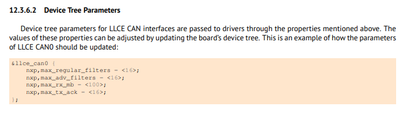

carlos_o
Hi @m_bez
1. If you want to do it with Yocto here is a guide to how to do your own modifications Yocto Project customization guide the guide is for the i.MX family but work very similar to the S32G in the Yocto Project.
Also, at the BSP Reference Manual you could find what modification is needed to the device tree:
[page 112, Linux BSP 42.0 User Manual for S32G3 platforms]
This changes you could do it at the file s32g399a-rdb3.dts for rdb3 or s32g274a-rdb2.dts for rdb2 located at
/your_Yocto_project/build_s32g274ardb2/tmp/work-shared/s32g274ardb2/kernel-source/arch/arm64/boot/dts/freescale/
2. Yes, at the ethernet chapter of the BSP manual you could find the following information:
So, at u-boot you could try something like
-> setenv fdt_override 'fdt addr ${fdt_addr}; fdt resize; fdt set <node> <property> <value>; ${fdt_override}'
and you need to use
node as /soc/llce_can0
property as nxp,max_regular_filters
value as you desire value
you need also to add another fdt set to the nxp,max_adv_filters property, only remember to separte each instruction with ; at the fdt_override string
Let me know if you have more questions.

carlos_o
Hi @m_bez,
Thanks for the questions!
At the LLCE firmware user guide at chapter 3.2.4.2 Llce_Fw_ReturnType you can find as you mentioned the table of the error enumerator below that table it mentioned where you can find this at the code "Definition at line 131 of file Llce_InterfaceFwMgr.h"
At the code I found the following with the enum 63:
Also, the error is listed at the Table of the User guide
Also, consider the following limitation for filters at your implementation:
