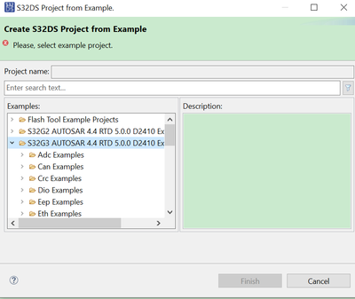

Dear NXP team,
I am facing an issue in S32DS build project from the example is not displaying [There is no reference examples] after installing all software bundles for S32G399ARDB3
  1. HSE_Standard_Firmware_0_2_51_0
  2. Inter_Platform_Communication_Framework_4_10_0
  3. LLCE_Standard_Driver_and_Firmware_1_0_9
  4. Real_Time_Drivers_5_0_0
Hardware Setup:
Board: S32G399ARDB3
OS: Windows
I have reinstalled all the software bundles several but still not able see reference example for s32g vnp rdb3 board
Any help and guidance will be appreciated
Jayanth KB

Seems you were testing it with S32DS3.6.1? which is quite new, I tested it on my end based on a S32DS3.6.0 setup, and installed the RTD5.0.0 manually from the images downloaded, the examples could be created for S32G3 successfully as follows:
I have checked your log, but seems the packages installed are not fully shown from your snapshot, would you mind sharing a full picture of it, to ensure if the RTD is well installed.
Chenyin
