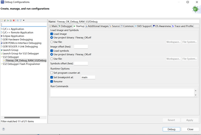

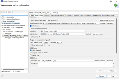

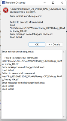

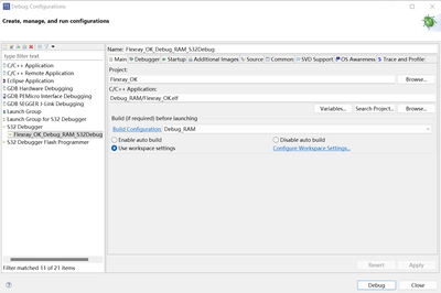

When I use S32DS for S32 Platform, the following error occurs when I use S32 Debug Probe for debugging.
Here is my configuration,I'm using the latest version S32DS for S32 Platform.
I tried to restart the software and development board, but nothing worked,Hope you can answer, thank you

Wanyj
Hi,Miguel04
Yes, I have tried other examples, each one has this problem, when I change the development board does not have this problem,Nothing else has been changed.
Is there some kind of unknown error with my development board? Something's wrong with me.
Looking forward to your reply, thank you
