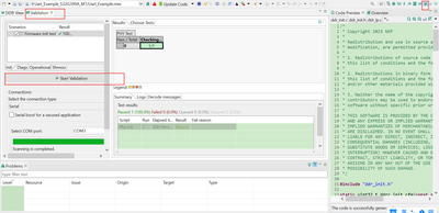

chenyin_h
Hello,  @Jayanth-KB
Tanks for your reply.
In order for connecting the board with DDR tools:
Firstly, you may have to change the switches on the board to "serial boot mode"; secondly, connect the UART0 to your PC; thirdly, open the S32DS, create or import a S32G3 project, then enter DDR tools, the necessary operation may be similar to:
Click on the "start Validation" to check the DDR.
Chenyin

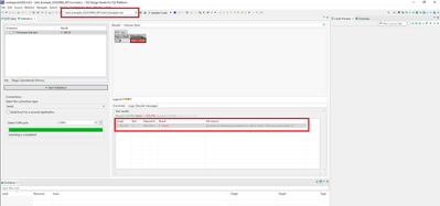

Jayanth-KB
Dear @chenyin_h,
Thanks for your reply.
I will follow the steps you outlined: switching the board to serial boot mode, connecting UART0 to my PC, and then using S32DS to create or import an S32G3 project before accessing the DDR tools.
There was a validation failure. Please let me know if there are any specific settings or additional considerations I should be aware of during this process.
Jayanth K B
