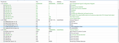

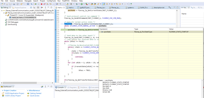

I use legacy flexray example(Flexray_ExternalCommunication_node1_S32G274A_M7 and Flexray_ExternalCommunication_node2_S32G274A_M7) but there is a issue while using it.
The code still at “pocState=Flexray_State_Startup” whild running it.

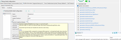

I’ve checked the FR_0/PSR0/STARTUPSTATE register, it shows “POC:integration listen” and I found the payload config seems incorrect
Could you help to advise what point I could check?

The only information that seems to be available for the "POC:integration listen" message seems to be provided under the following thread:
FlexRay: Coldstart Listen - NXP Community
"after short discussion with FlexRay expert, it looks like there's only one node. FlexRay system needs at least two nodes to have each node move into normal active state. With just one node and an oscilloscope you will be able to see the node sending several startup frames, but nothing more."
Can you help us confirm this situation?
As for the payload, since it is an info level message, we cannot confirm nor deny if there is a problem with it.

Since the customer seems to be using RDB2, as said before, this board does not integrate the Flexray PHY under the normal FR pins.
This functionality was confirmed with the EVB platform, from our internal team. Does the client have the possibility to have access to an EVB platform?
As for the message that appears on Config Tools, it is no an error level message, it is an info level one, which should not be a problem with the overall functionality of the example.

Daniel-Aguirre
Under RDB2, the following is said from our internal team:
"FlexRay could not be tested on RBD2, the hardware did not connect to PHY."
