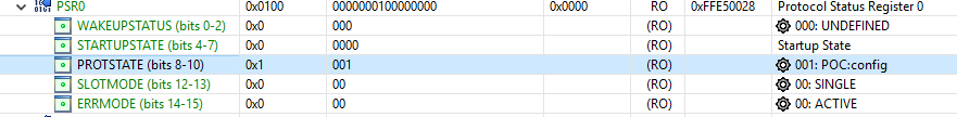

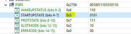

But when I click on "Resume or F8" I can see few of the Protocol Configuration Register (PCR0 to PC5) are set with 0x0000. See below image 1.
If I perform "Single Step (F5)" debugging I can see these PCR are updating with required values.See below image 2.
Do I need to give some delay before configuring this Protocol Configuration Register?
