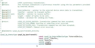

Hello i am using S32K312, i need to interface the Spansion S25 flash using RTD, i am using  Lpspi_Ip_SyncTransmit() function to transmit and receive the data , but the function description tells the length parameter is number  of bytes to send, but how can we receive the required number of bytes using the same function?

Hello @VaneB,
Can you please tell me how the LPSPI functions work if we have different transmit and receive bytes?
For instance i need to send X bytes and need receive Y bytes( in my case with SPI flash i need to send 4 byte data(command+address) and need to receive the required number of bytes) with LPSPI functions.

Hi @sai-bodhanapu
I suggest you test the LPSPI examples included in the RTD. To know how the module works.

Hi @sai-bodhanapu
If you take a look at the Lpspi_Ip_SyncTransmit(), this function calls Lpspi_TransmitTxInit() and Lpspi_TransmitRxInit() which receives as a parameter their respective buffer and the same length which is the one defined in the call of Lpspi_Ip_SyncTransmit().
This means that this function was designed so that transmission and reception work with the same number of bytes.
Please let me know if the explanation is clear or if it is not what you were looking for.

sai-bodhanapu
Hello Vane, then what is the difference between the SyncTransmit and AsyncTransmit functions? so the length parameter is same in both?
