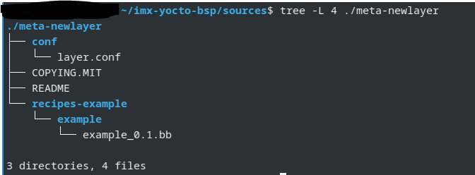

##Check that it has been added correctly
$ tree -L 4 ./meta-newlayer
##Edit the new layer and delete the samples created by yocto
$ cd meta-newlayer
$ rm -r recipes-example
$ rm conf/layer.conf

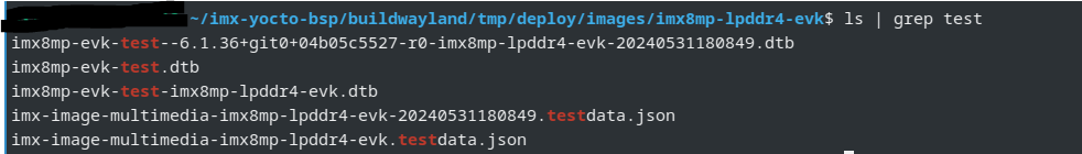

##Finally we bitbake our image
$ cd ~/imx-yocto-bsp/buildwayland
$ bitbake imx-image-multimedia
#All the images built should appear at  <build directory>/tmp/deploy/images/<machine>
