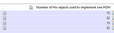

Hi, NXP Experts,
I'm testing LLCE CAN performance on S32G399A.
The testcase is:
1.Transmit 10 Classic CAN Messages on 100ms period to BCAN0 by CANoe
2.Configure LLCE_CAN and LLCE_AF to route the BCAN0 received 10 Classic CAN Messages to BCAN1
3.Use CANoe monitor messages on BCAN0(CAN 1) and BCAN1(CAN 2) bus
From following CANoe Trace window, we could found that some CAN messages route failed(red underline marked)
The questions are:
1.Is the test result reasonable?
2.If not reasonable, what should i do to solve the problem?
3.Does NXP could provide the benchmark about LLCE routing performance?

The issue solved with the help from local FAE by decrease the Number of Hw objects used to implement one HOH of Tx HOH. Because the deep of Tx_lut FIFO is 16. the CAN2CAN used the remaining FIFO count of HTH.

In Lauterbach, there's a NO_MB_AVAILABLE error recorded in Can_SharedMemory variable.
But i don't know why this error occurs, 15 Number of Hw objects have configured for transmitting.
