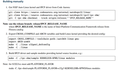

I want to use Linux BSP40 + SW32G_IPCF_4.9.0_D2310 on A53 core of s32g274ardb2 and verify using
ipc-shm-sample_uio.elf
 Building steps are mentioned in ipc-shm/sample_user/README.rst at release/SW32G_IPCF_4.9.0_D2310 · nxp-auto-linux/ipc-shm
After edition MAKEFILE of sample_user as
CFLAGS += -Wall -g -I$(libipc_dir)/.. -DCONFIG_SOC_$(PLATFORM) -Iinclude -I/opt/fsl-auto/40.0/sysroots/cortexa53-crypto-fsl-linux/usr/include
I am able to build .elf file.
Be informed  that sdk40 is installed on system after populating sdk40 from yocto build system.
Once I copied .elf file via ssh and ran, I got "Bus error" but ips_shm_uio.ko is getting inserted automatically.
While building "ipc-shm-sample_uio.elf", I got some warnings which I resolved successfully.
If I am building "ipc-shm-sample_uio.elf", using bsp40 yocto build system, still I am not able to run it as expected and getting below kernel panic errors.
Requesting to guide me to resolve the above errors and suggest me which method would be correct and less-error prone to build "ipc-shm-sample_uio.elf" application.
8,817 Views

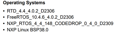

Daniel-Aguirre
We are looking into the IPCF 4.9.0 release notes and see the following information:
Where both RTD and BSP versions are different from the ones you are using. Can you help us verify if using the required versions for both RTD and BSP provides the expected outcome? We do apologize for the inconvenience.
Please, let us know.

 As per your suggestion, I updated following OS versions:
     RTD_4.4_4.0.2_D2306
     NXP Linux BSP37.0[ As on github page not able to find 38.0 version.]

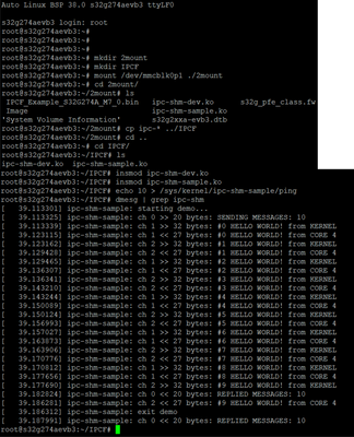

But still we are not able to get expected output messages on A core as mentioned in "Description.txt"
Below are messages just for references.
[ timestamp ] ipc-shm-sample: ipc-shm-sample: starting demo...
[ timestamp ] ipc-shm-sample: ipc-shm-sample: ch 0 >> 20 bytes: SENDING MESSAGES: 10
[ timestamp ] ipc-shm-sample: ch 1 >> 32 bytes: #0 HELLO WORLD! from KERNEL
[ timestamp ] ipc-shm-sample: ch 1 << 32 bytes: #0 HELLO WORLD! from CORE 4
[ timestamp ] ipc-shm-sample: ch 2 >> 32 bytes: #1 HELLO WORLD! from KERNEL
[ timestamp ] ipc-shm-sample: ch 2 << 32 bytes: #1 HELLO WORLD! from CORE 4
[ timestamp ] ipc-shm-sample: ch 1 >> 32 bytes: #2 HELLO WORLD! from KERNEL
[ timestamp ] ipc-shm-sample: ch 1 << 32 bytes: #2 HELLO WORLD! from CORE 4
[ timestamp ] ipc-shm-sample: ch 2 >> 32 bytes: #3 HELLO WORLD! from KERNEL
[ timestamp ] ipc-shm-sample: ch 2 << 32 bytes: #3 HELLO WORLD! from CORE 4
[ timestamp ] ipc-shm-sample: ch 1 >> 32 bytes: #4 HELLO WORLD! from KERNEL
[ timestamp ] ipc-shm-sample: ch 1 << 32 bytes: #4 HELLO WORLD! from CORE 4
[ timestamp ] ipc-shm-sample: ch 2 >> 32 bytes: #5 HELLO WORLD! from KERNEL
[ timestamp ] ipc-shm-sample: ch 2 << 32 bytes: #5 HELLO WORLD! from CORE 4
[ timestamp ] ipc-shm-sample: ch 1 >> 32 bytes: #6 HELLO WORLD! from KERNEL
[ timestamp ] ipc-shm-sample: ch 1 << 32 bytes: #6 HELLO WORLD! from CORE 4
[ timestamp ] ipc-shm-sample: ch 2 >> 32 bytes: #7 HELLO WORLD! from KERNEL
[ timestamp ] ipc-shm-sample: ch 2 << 32 bytes: #7 HELLO WORLD! from CORE 4
[ timestamp ] ipc-shm-sample: ch 1 >> 32 bytes: #8 HELLO WORLD! from KERNEL
[ timestamp ] ipc-shm-sample: ch 1 << 32 bytes: #8 HELLO WORLD! from CORE 4
[ timestamp ] ipc-shm-sample: ch 2 >> 32 bytes: #9 HELLO WORLD! from KERNEL
[ timestamp ] ipc-shm-sample: ch 0 << 20 bytes: REPLIED MESSAGES: 10
[ timestamp ] ipc-shm-sample: ch 2 << 32 bytes: #9 HELLO WORLD! from CORE 4

Thanks for your feedback. We understand that you are using BSP37.0, is this correct? If so, we understand that IPCF v4.9.0 is not compatible with BSP37.0 (as previously shown).
Still, once you are able to locate BSP38.0, the default version under BSP38.0 is v4.8.0. If you would like to use IPCF 4.9.0, you need to update the IPCF version under BSP38.0 to v4.9.0. The following was provided by the internal team:
"Please confirm that the IPCF version in BSP38 is IPCF4.9.0. Because the default IPCF version in BSP38 is 4.8.0. I have tested the configuration as customer configured for the demo, and it works."
We can also recommend using IPCF v4.8.0 or v4.6.0.

We do understand that you are using BSP38.0, but the default IPCF version under BSP38.0 is IPCF v4.8.0, for which we understand that you are using the following scenario:
BSP38.0 (with IPCF v4.8.0) + IPCF v4.9.0
Which is causing problems. If you wish to use IPCF 4.9.0, you need to also update the BSP38.0 IPCF version to v4.9.0, hence the following comment from the internal team:
"Please confirm that the IPCF version in BSP38 is IPCF4.9.0. Because the default IPCF version in BSP38 is 4.8.0."
Help us understand if you can follow the example with IPCF v4.8.0, for us to confirm that BSP38.0 default IPCF version is indeed IPCF v4.8.0.

We don't see any specific information on how to remove the current IPCF version, but as for building it, we see the following information:
Where the clone should be changed to the following repo:
https://github.com/nxp-auto-linux
We have done the following steps to build IPCF v4.9.0 under BSP38.0:
  • [Under the same folder as linux BSP38.0 folder was created]
  • git clone https://github.com/nxp-auto-linux/ipc-shm
  • cd ipc-shm/
  • git checkout release/SW32G_IPCF_4.9.0_D2310
  • cd ..
  • [link to where your toolchain is located] export CROSS_COMPILE=$HOME/../arm-gnu-toolchain-11.3.rel1-x86_64-aarch64-none-linux-gnu/bin/aarch64-none-linux-gnu-
  • cd linux
  • make ARCH=arm64 s32cc_defconfig
  • make ARCH=arm64 -j8
  • cd ..
  • make -C ./ipc-shm/sample KERNELDIR=$PWD/linux modules PLATFORM_FLAVOR=s32g2
  • Copy "ipc-shm/ipc-shm-dev.ko" and "ipc-shm/sample/ipc-shm-sample.ko" to the "boot" partition of the BSP38.0 SD card image.
  • Copy "linux/arch/arm64/boot/Image" file the "boot" partition of the BSP38.0 SD card image (replace the Image file that was previously in there).
After this, start following the IPCF "description.txt" file instructions for v4.9.0:
1. Copy the stripped binary (IPCF_Example_S32G274A_M7_0.bin) to a FAT partition
on a SD-card
2. Establish a serial connection with the S32G274A board and power it on
3. Hit any key to stop in the u-boot console
4. Disable Data Cache from uboot::
dcache off
5. Zero-set SRAM shared memory used by both sample apps::
mw.q 0x34100000 0x0 0x40000
6. Load binary in DDRAM and after is SRAM::
fatload mmc 0:1 0x80000000 IPCF_Example_S32G274A_M7_0.bin
cp.b 0x80000000 0x34300000 0x300000
7. Start M7 core (the argument is the address of the Interrupt Vector)::
startm7 0x34500400
8. Boot Linux ::
boot
Then, execute the following commands under the user-space:
