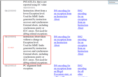

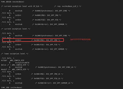

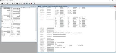

During repetitive power cycling tests, we observed intermittent boot failures on the device. The issue has been preliminarily traced to a synchronous exception triggered during OS initialization, causing the system to hang. Details are as follows:
  1. Failure Context:
    • CPU is stuck at the synchronous exception vector entry, with the PC pointer frozen.
    • PC, ELR_EL1, and FAR_EL1 all point to the exception entry address 0xFFFFFFFF802E6200 (VBAR_EL1 = 0xFFFFFFFF802E6000).
    • ESR_EL1 = 0x86000004 (EC=0x21, IFSC=0x04: Instruction Abort, Translation fault at level 0).
    • DDR memory content is unreadable via Lauterbach debugger.
  2. Hypothesis:
    The CPU enters a deadlock when attempting to jump to the synchronous exception handler (VBAR_EL1 + 0x200), likely due to invalid page table mappings for this address, causing recursive exceptions.
  3. Open Questions:
    • How to identify the original exception trigger point (the initial faulting instruction)?
    • Why is DDR memory inaccessible via the debugger during this state?
How should I proceed with the next step of troubleshooting?
