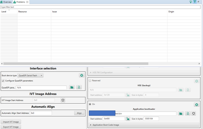

Hi  expert:
i build the bootaloder image, step by <S32G_Bootloader_V2>

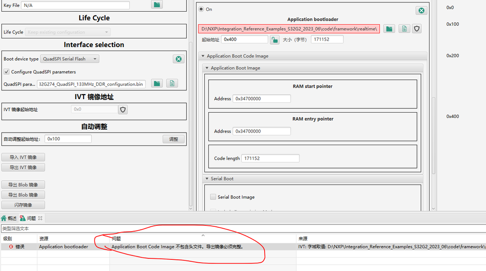

when i make the ivt dcd image , S32DS IVT Config Tool report error "Application Boot Code Image not include head file. the export file must be complete"
this issue can  recurrented by 3 step

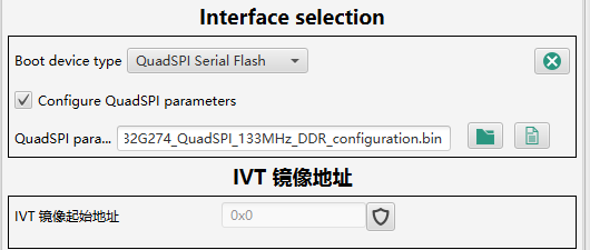

step 1:
add S32G274_QuadSPI_133MHz_DDR_configuration.bin in Interface selection
file path :D:\NXP\Integration_Reference_Examples_S32G2_2023_06\code\framework\realtime\swc\bootloader\platforms\S32G2XX\res\flash

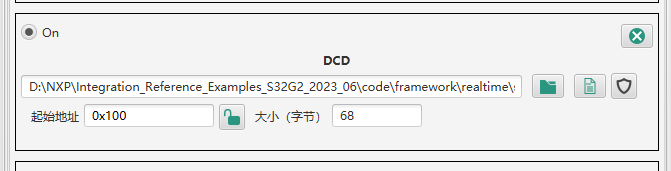

step 2
add S32G274_DCD_InitSRAM.bin in  DCD
step3:
add Bootloader.bin  in Application bootloader
Pls Help
1,805 Views
Daniel-Aguirre
For the error you are mentioning:
It seems that the Application Bootloader has not been exported, as shown below:
DanielAguirre_1-1706808660292.pngDanielAguirre_1-1706808660292.pngDanielAguirre_2-1706808723173.pngDanielAguirre_2-1706808723173.png
Please, let us know.
1,781 Views
Archieeeee
Hi  Daniel:
thanks for you reply,
 it's work ok, after export image
