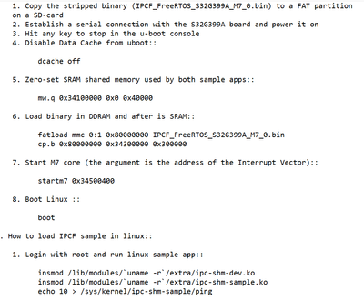

I have been trying to solve the example project which was given in the IPCF 4.9.0 package.
I was following the below steps,
The expected output has to be like
But i am getting an error as follows when i try to ping
Please let me know how to debug this error.

Abhiram_m_s
Hello @chenyin_h ,
The solution you provided worked when I ran IPCF_Example_multi_instance_S32G399A_M7 example. Thank you for your help.

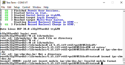

Abhiram_m_s
Hello @chenyin_h ,
I followed the step 2 as u mentioned, ipc-shm-dev.ko file got inserted, but when i try to insert ipc-shm-sample_multi_instance.ko, i am getting the following error :
Please let me know how to proceed.

Abhiram_m_s
Hi @chenyin_h ,
We used the toolchain GCC 11.3.0 as u mentioned above and we built the ipc-shm-dev.ko and ipc-shm-sample_multi_instance.ko.
When i insmod the ipc-shm-dev.ko, i am getting following error.
Please let us know how to proceed
You can see the .ko files being generated
5,961 Views

Abhiram_m_s
Hello @chenyin_h ,
Since we are new to this, can you let us know hot to build the .ko files which was mention by you in point number 3.
Thank you.
