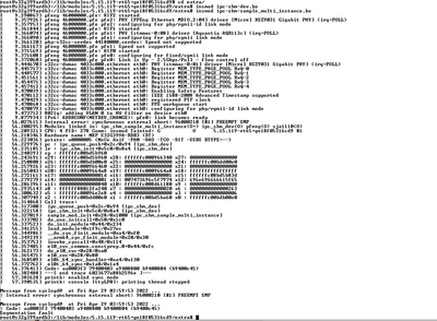

Hi @chenyin_h ,
We used the toolchain GCC 11.3.0 as u mentioned above and we built the ipc-shm-dev.ko and ipc-shm-sample_multi_instance.ko.
When i insmod the ipc-shm-dev.ko, i am getting following error.
Please let us know how to proceed

chenyin_h
Hello, @Abhiram_m_s
Thanks for the feedback.
I have the following input for your reference.
git clone https://github.com/nxp-auto-linux/ipc-shm.git
git checkout SW32G_IPCF_4.9.0_D2310
make CROSS_COMPILE=/TOOLCHAINPATH/arm-gnu-toolchain-11.3.rel1-x86_64-aarch64-none-linux-gnu/bin/aarch64-none-linux-gnu- PLATFORM_FLAVOR=s32g3 KERNELDIR=/KERNELPATH
Then the new *.ko files would be generated.
Hope it helps.

chenyin_h
Hello, @Abhiram_m_s
Thanks for the feedback, the most possible reason is that the version used under Linux is not correct, my suggestions are as follows:
  1. The RFS from BSP38.0 is correct for testing the IPCF4.9
  2. However, do not use the default *.ko files under /lib/modules/, since the code version is not compatible with the demo/example you were running.
  3. Instead, download the code from https://github.com/nxp-auto-linux/ipc-shm, checkout the IPCF4.9.0, then build out module files.(*.ko)
  4. Copy the newly built *.ko files to your RFS, insmod them, then continue your test to have a try.
Hope it helps.
