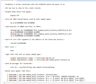

I download the IPCF_Example_multi_instance_S32G274_M7 from NXP, and I build it and get IPCF_Example_multi_instance_S32G274_M7_0.bin, then I am following steps as description.

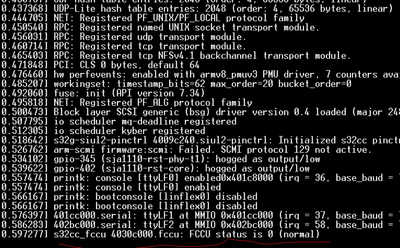

I use BSP36.0 to uboot the s32g274ardb2 from SD card,  but it stops in FCCU.

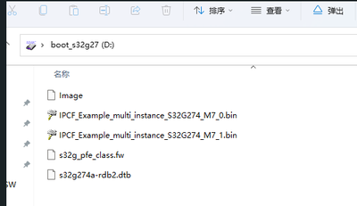

BSP36.0's image in SD card :

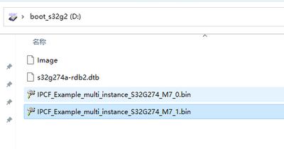

Then I use binaries_auto_linux_bsp33.0_s32g2_pfe from NXP, then I uboot from board and write commands , it reports errors:mscm errors , it seems to rebuild bsp33.0?
BSP33.0's image in SD card :

We have verified the use of IPCF previously under BSP36.0 and we did not encounter any problem. Are you using the provided NXP BSP? Or are you building your own?
For the last question you are asking, we assume you are building your own. Under the prebuilt NXP BSP, the "s32g_pfe_class.fw" is already provided.

the "s32g_pfe_class.fw" is already provided. I do not understand, can you tell me why I change the uboot, it stops in FCCU?

As for uboot stopping under the FCCU, it could be due to a problem with the image, since we cannot reproduce the behavior under the NXP provided image. We do apologize.
