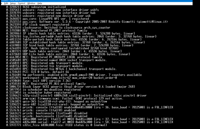

Then I use BSP36.0 in S32g274ardb2,then I use the steps :
but the uboot stop it in FCCU

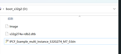

I will show you the content in SD card

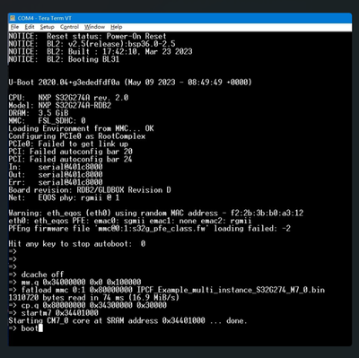

 I aslo try binaries_auto_linux_bsp33.0_s32g2_pfe in NXP, and I write the command in uboot , uboot and kernel start up succesfully , but when I put the command: insmod ipc-shm-sample_multi-instance.ko , it shows invaild parameter.
Could someone tells me how to fix it?

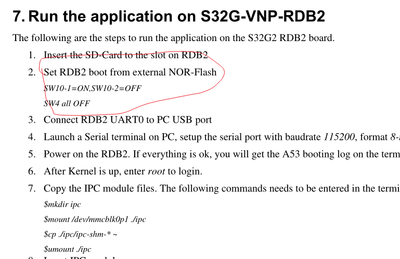

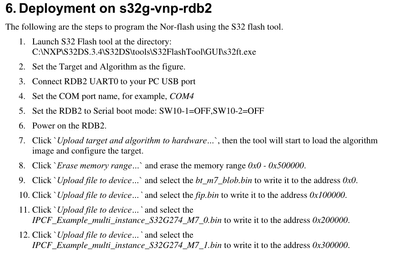

I am following AN13750 steps again, try to boot from NOR flash, but when I  program the Nor-flash and insert the SD card , I found nothing in Tera Term, it seems that it is not in linux.
I  will upload the IPCF project and files , please help me.
