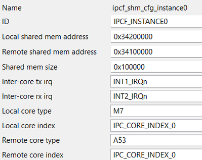

I use S32G-VNO-GLDBOX ver. 47800 REV D1 with IPCF 4.9.0 D2310, RTD 4.0.2 D2306, Linux BSP 38.0.
I'm trying to run the example following the instructions from the description file, but I'm not able to get the expected result.
.intc_vector 0x34500400,
linker file settings:
won0020_0-1711460672531.pngwon0020_0-1711460672531.png,
ipcf peripheral settings:
won0020_1-1711460906465.pngwon0020_1-1711460906465.png,

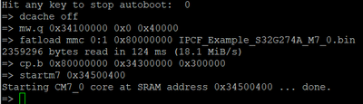

loading the IPCF sample from u-boot console:
won0020_2-1711461012096.pngwon0020_2-1711461012096.png,

Daniel-Aguirre
This seems to be related to the following community thread:
Re: Issue with NXP S32G274A RDB2 -  IPCF - NXP Community
In which there is a conflict between IPCF versions (from IPCF example and IPCF under Linux). A solution was provided on the link above.
Hope it helps with this inquiry.
Please, let us know.

won0020
I reconfigured the entire S32DS example 4.9.0 according to 4.8.0 and now it works with BSP 38.0 and 39.0.
