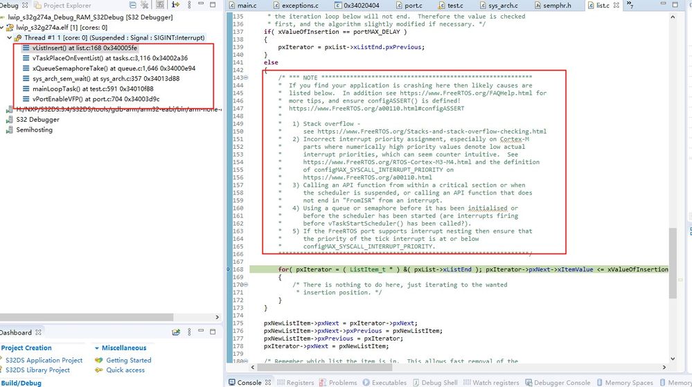

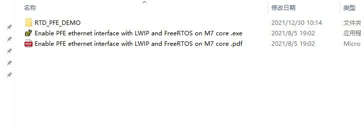

        Recently,i am debug the Ethernet function of S32G274 and  i meet a problem need to be helped.I install the TCP/IP Stack SDK and use the demo project "lwip_s32g274a" to test the TCP function.With the help of the demo project,i succeed to realize the TCP stack on my develop board(S32G-VNP-RDB2) base on GMAC.Later,i want to test the PFE-MAC2 on the M core,So i download the "PFE-DEMO" on NXP's Website ,and configure the project follow as the Application Note,which is show as below pic:
    After finishing the step mention in application note,i complier the project and download it into my develop broad,it always stuck in some place which is show as below pic:
      It seem that it's the FreeRTOS have any problem. Can you give me some tips about how to solve this prolem?The purpose i want to do is that use the PFE-MAC2 on the cortex-M7 core to realize the TCP stack.

Is this problem persistent over all PFE interfaces?
As for the FreeRTOS, have you tried following the different options provided in the code? When is the code jumping to that code section? Is it after trying to access an interruption?
Please, let us know.

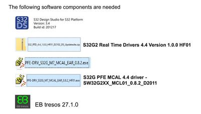

     I think maybe it caused by the reason that the SDK and IDE version is incompatible.
     The version information in the  "GUIDE TO ENABLE PFE WITH LWIP BASED ON RTD" is show as follow figure:
However,my IDE version and SDK version is different form it,which is show as follow:

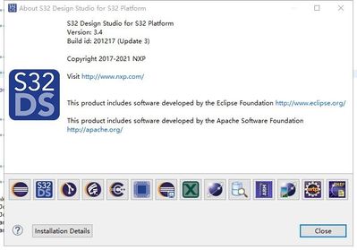

(1)IDE version:

      It seem that my IDE version and SDK version are all different from the version mention in the "GUIDE TO ENABLE PFE WITH LWIP BASED ON RTD".
      Can you tell me based on my SDK and IDE version,what should i do to make the PFE driver compatibility?
