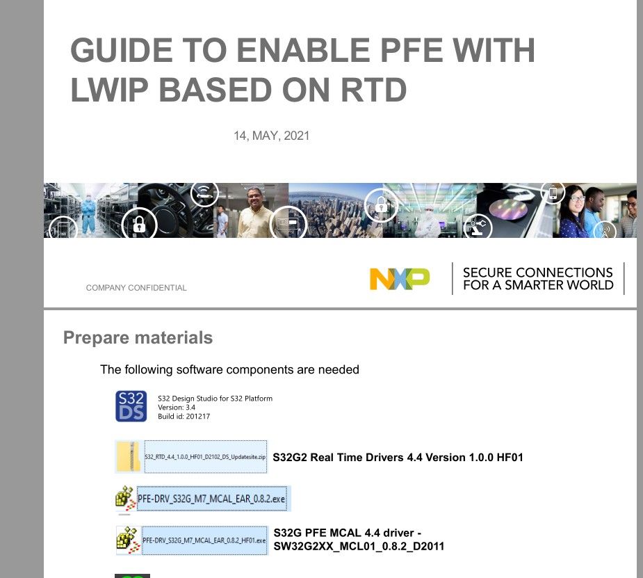

     The version information in the  "GUIDE TO ENABLE PFE WITH LWIP BASED ON RTD" is show as follow figure:

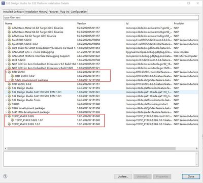

However,my IDE version and SDK version is different form it,which is show as follow:
(1)IDE version:
(2)SDK version
      It seem that my IDE version and SDK version are all different from the version mention in the "GUIDE TO ENABLE PFE WITH LWIP BASED ON RTD".
      Can you tell me based on my SDK and IDE version,what should i do to make the PFE driver compatibility?
