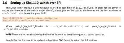

Are sja1110_switch.bin and sja1110_uc.bin needed to enable sja1105 switch? And what is SW12 1-1 positoin?
Thank you and best regards.
