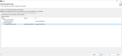

Daniel-Aguirre
It seems there is a dependency with FreeRTOS 3.0.2, but you have FreeRTOS 3.0.4. This is shown in the "S32G_SDHC_RTM_1_0_1_HF1_D2207_Release_Note.pdf" as mentioned below.
Have you tried installing the specific FreeRTOS version?
Please, let us know.

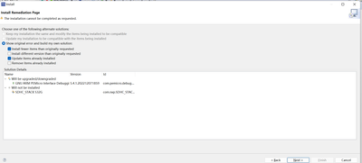

StanleyShen
Just refer to the S32GDS -> help -> Installation Details
It seems that the FreeRTOS and SDHC was installed succesfully. but when I want to create a sample project,
the project did not include the FreeRTOS and SDHC source code folder.
can you tell me why?

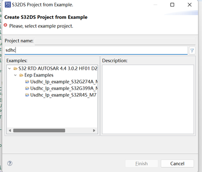

Daniel-Aguirre
The text "sdc" should not bring any results due to the package being "sdhc". One example provided in this package is "sdhc_fatfs_s32g274a".
As for the code generation, within NXP examples, there is a need for generating configuration files. This is done through "ConfigTools" provided in S32DS. If the code is not generated, the compilation will fail due to the drivers/configuration files not being generated by the tool.
You right-click on your project, click on "S32 Configuration Tools > Open Peripherals" then click on "Update Code" button. This should generate the needed files for the out of the box experience.

StanleyShen
[The text "sdc" should not bring any results due to the package being "sdhc". One example provided in this package is "sdhc_fatfs_s32g274a".]
sorry for the poor sample, but typed the "sdhc", still don't work

When I use the "help->S32DS Extesions and updates" to install again,
the infomation like blow, could you explain this?
And, Why do the following diagram always come out, how to clear it?

StanleyShen
I download the FreeRTOS 3.0.2 from  [Automotive Software Package Manager] and reinstalled it,
both the FreeRTOS and SDHC have been installed correctly.
Thank you very much and pls let me close reslove question.

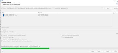

StanleyShen
Dear
Since the manual as attached, it seems that [from ‘Help’ menu select ‘Install New Software...]  was recommend,
But still, I installed from  "Help > S32DS Extensions and Updates"
when I chose the [SW32G_SDHC_RTM_1_0_2_D2209_updatesite.zip!]
"Unsuitable Packages for Platform " was popped.

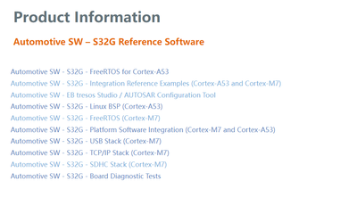

BTW,
the SDHC was downloaded like this
(Even the newest one is still NG)
