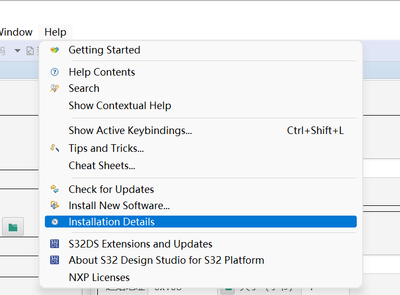

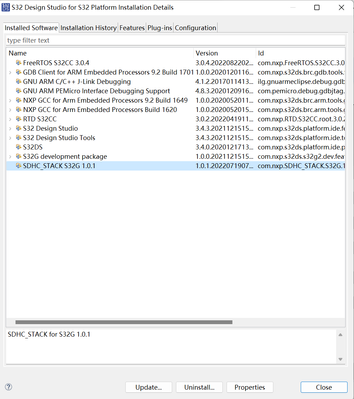

StanleyShen
Just refer to the S32GDS -> help -> Installation Details

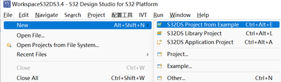

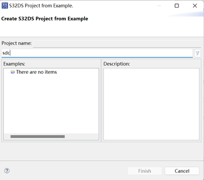

It seems that the FreeRTOS and SDHC was installed succesfully. but when I want to create a sample project,
the project did not include the FreeRTOS and SDHC source code folder.
can you tell me why?

Daniel-Aguirre
The text "sdc" should not bring any results due to the package being "sdhc". One example provided in this package is "sdhc_fatfs_s32g274a".
As for the code generation, within NXP examples, there is a need for generating configuration files. This is done through "ConfigTools" provided in S32DS. If the code is not generated, the compilation will fail due to the drivers/configuration files not being generated by the tool.
You right-click on your project, click on "S32 Configuration Tools > Open Peripherals" then click on "Update Code" button. This should generate the needed files for the out of the box experience.

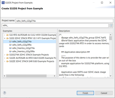

StanleyShen
[The text "sdc" should not bring any results due to the package being "sdhc". One example provided in this package is "sdhc_fatfs_s32g274a".]
sorry for the poor sample, but typed the "sdhc", still don't work
Refer to the SDHC release note, the correct image as blow:

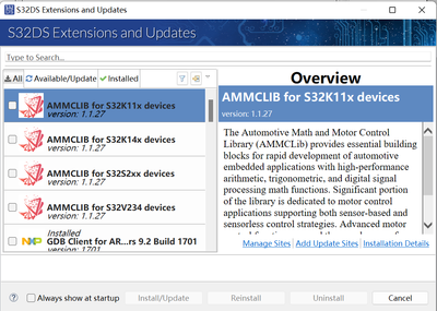

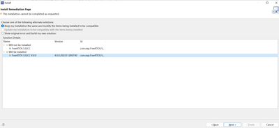

Also,
When I use the "help->S32DS Extesions and updates" to install again,
the infomation like blow, could you explain this?
And, Why do the following diagram always come out, how to clear it?

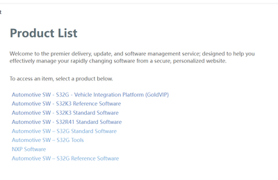

StanleyShen
I download the FreeRTOS 3.0.2 from  [Automotive Software Package Manager] and reinstalled it,
both the FreeRTOS and SDHC have been installed correctly.

Daniel-Aguirre
Have you tried using the "Add Update Sites" option under "Help > S32DS Extensions and Updates"?
You click on the option and a window will pop asking for the "updatesite.zip" file. If the update site is compatible with your S32DS version, this should add the package to the Extensions and Updates window and you can select it for installation. You should have the pre-requisites installed prior to installing this package. If not, it will fail.

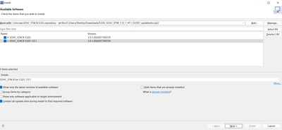

3,997 Views

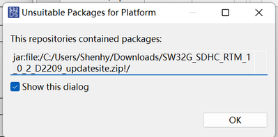

StanleyShen
Dear
Since the manual as attached, it seems that [from ‘Help’ menu select ‘Install New Software...]  was recommend,
But still, I installed from  "Help > S32DS Extensions and Updates"
when I chose the [SW32G_SDHC_RTM_1_0_2_D2209_updatesite.zip!]
"Unsuitable Packages for Platform " was popped.

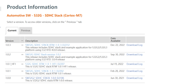

BTW,
the SDHC was downloaded like this
(Even the newest one is still NG)
Otherwise, I continued to install FreeRTOS because I was worried about the dependency with FreeRTOS as the same way, but it seems to have no effect(even I don't think FreeRTOS has been successfully installed)
