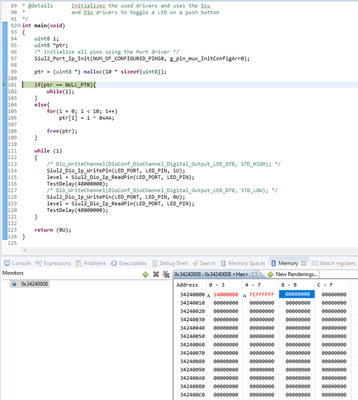

Hi Sir,
Could you provide an example of allocating & releasing memory on S32DS?
1,659 Views
Daniel-Aguirre

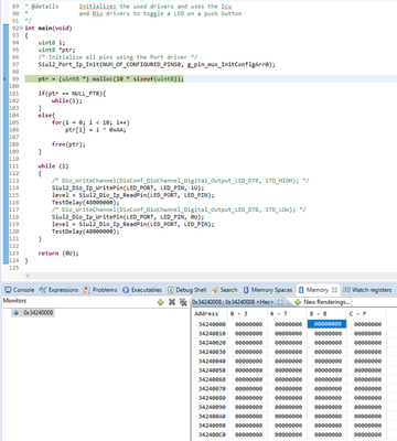

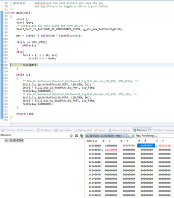

Are you referring to the usage of malloc() and free() functions?
If so, we do not see any specific implementation for it. You should be able to use it just by adding the required library, as shown below:
Please, let us know.
