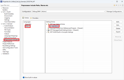

Thanks for the reply.
I've follow the solution you provided to test it on one of NXP Uart example code, but it seems not to work on the project.
May I check the testing process with you?
process
1.create MACRO.h and add it to ${ProjDirPath}/ with the same content
2.add it to CDT_User_Setting_Entries
3.add #IF conditional in main.c
the #if block did being shaded if changing the compared value with TEST to 150
result
the warning messge was shown in the build log
flash binaries and monitor with uart terminal software
thanks in advance!

Thanks for your feedback. It seems that as you are saying, the GUI shows as if the Macro has been detected, but at compilation it does not take it into account.
Digging further into this topic, seems that S32DS has a bug regarding this same topic. A thread below mentioning this:
Solved: Macros to access filename - NXP Community
I've tried with S32DS v3.5 (since it is the newer version) but I cannot get it working. We apologize.
On the above-mentioned thread, there is a possibility of adding the flag directly into the command line pattern, but we don't know if it is what you are looking for.
Please, let us know.
