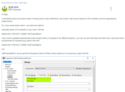

I've followed the solution mentioned in the below image by first executing a script to get git info, then
writing it into the header file which would be included in the main.c in Pre-build steps.

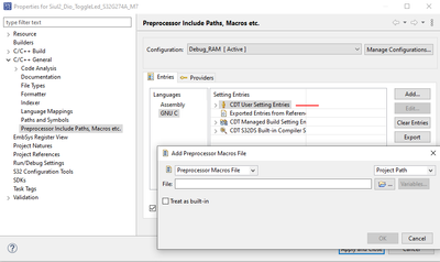

There is the possibility of adding a "Preprocessor Macros File" to your project, in which you could add new macros. Below will be a picture of where to add this kind of file:

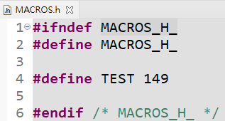

For our test, before trying to add the file, we created a new header file on the project by the name "MACROS.h" in which we have the following information:
#ifndef MACROS_H_
#define MACROS_H_
#define TEST 149
#endif /* MACROS_H_ */

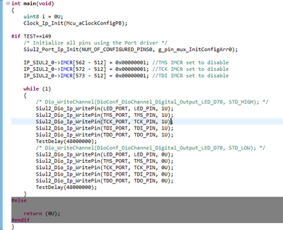

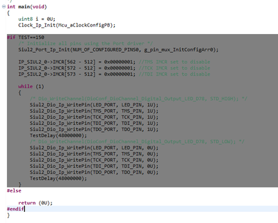

We then added the "Preprocessor Macros File" as shown on the image above and created the #IF conditional on our project. Below the results:
If met:
If not met:

2.add it to CDT_User_Setting_Entries

the #if block did being shaded if changing the compared value with TEST to 150
After flashing binaries, it works!
