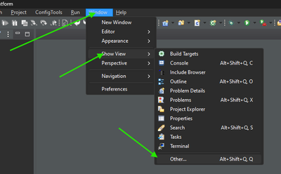

Hello @Jeff-CF-Huang,
Sorry for the late reply and also sorry for not understanding your request correctly at the beginning. It seems that the problem is the use of the command line, you should be able to register the secure key in S32DS, following these steps:
This will open the required view:
However, you must have a smart card, if you don't have one please check the attached presentation.
Please let me know if I understood your request correctly.

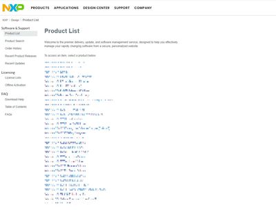

Thanks for reaching out to us and sorry for the late reply. About your questions, I am assuming you are looking for the procedure to flash the ADKP into the S32G chip. To do that you will need to download the HSE FW and call the respective HSE service. For reference you can check the HSE DEMO APP. You can find both by following these steps:
- Access www.nxp.com/ and login into your account.
- Click on My account and then on Software Licensing and support
- Click con View accounts
- You should see a page like the following with all your products
- Follow this path Automotive SW – S32G Standard Software >Automotive SW - S32G - HSE Firmware
- Then select the version you are interested in, depending on your setup:
- For example HSE FW 0.2.64.0 SR Release for S32G2, then you can doanload both the FW and DEMO APP:
Once executed you will find all files in the installation directory.
Please let me know if you have more questions

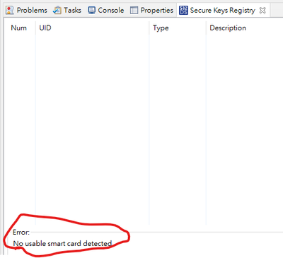

Jeff-CF-Huang
Hi Alejandro,
Yes, I've followed the steps you mentioned.
Currently, I'm trying to register the ADKP on the Secure Keys page.
However, I'm encountering an issue where the message "No usable smart card detected" appears on the Secure Keys Registry page.
I'm not sure how to resolve this.
Jeff Huang
811件の閲覧回数
alejandro_e
It seems that the document you shared originally does not go into the details of how to configure S32DS to debug a secured device. Please check the following post for those details:
