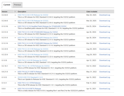

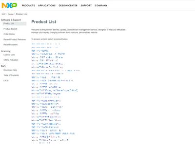

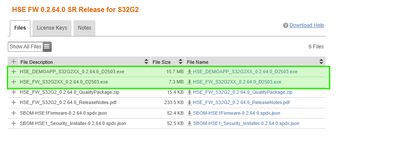

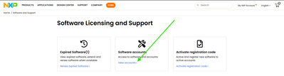

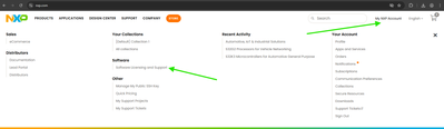

Hello @Jeff-CF-Huang,
Thanks for reaching out to us and sorry for the late reply. About your questions, I am assuming you are looking for the procedure to flash the ADKP into the S32G chip. To do that you will need to download the HSE FW and call the respective HSE service. For reference you can check the HSE DEMO APP. You can find both by following these steps:
- Access www.nxp.com/ and login into your account.
- Click on My account and then on Software Licensing and support
- Click con View accounts
- You should see a page like the following with all your products
- Follow this path Automotive SW – S32G Standard Software >Automotive SW - S32G - HSE Firmware
- Then select the version you are interested in, depending on your setup:
- For example HSE FW 0.2.64.0 SR Release for S32G2, then you can doanload both the FW and DEMO APP:
Once executed you will find all files in the installation directory.
Please let me know if you have more questions
