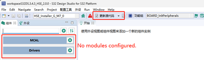

I am implementing HSE_DEMOAPP_S32G2_0_1_0_5 on S32G-VNP-RDB2.
I using S32DebugProbe in S32 Design Studio 3.4.3, RTD 3.0.2HF01 and development package 3.4.3.
Folllowed the steps in Readme to abtain the blob image, I can't get any message from the Serial Port when I run this image in the board.

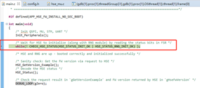

When I debugged the elf, I found it stuck in the while loop below:
And the MUB0_FSR is 0,
Here is the blob image I made.
Could you share a blob image which works well on S32G-VNP-RDB2 with me?
Thank you.

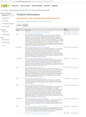

For what you are showing, it seems HSE was not installed correctly.
The following information is provided under the HSE_DEMOAPP readme:
For which, RTD v2.0.0 is the package required for the project, not RTD v3.0.2 HF01. Can you help us verify if this behavior remains once the correct RTD version is used?

I checked my software account, there is no RTD2.0.0HF04 for me,
And I try RTD2.0.0HF02, it still not work.
After this, I installed an new environment with S32DS3.4.3+developmentpackage3.4.3, but I did not installed any RTD, the hse demo can still be built, so I thought maybe it doesn't rely on any RTD.
Could you help me verify this in your environment? Thank you!

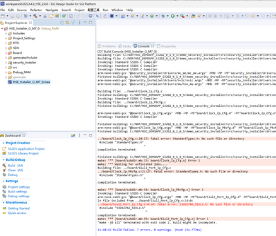

I did not open the mex file to Update Code, because if I did this, the project can not be built:
It must be built directly without generating any code.

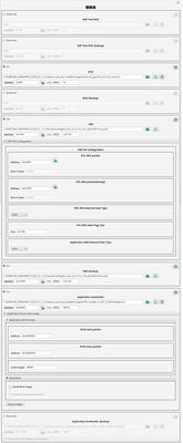

As for any issues we are seeing, can you help us sharing the IVT structure that you are creating? The capture from Config Tools should be good, for us to understand if there is no problems with the IVT itself.

Here is the IVT I am using:
Attachment is my blob image from this IVT.
Thank you. 
5,444件の閲覧回数
Daniel-Aguirre
Thanks for the information.
We are not seeing that much difference on your IVT structure, just the usage of a different DCD, which is also provided within the DEMOAPP.

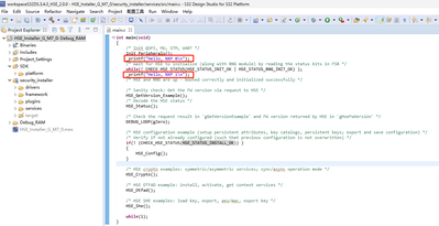

I added 2 print commands in the main function, as this:
rebuild the project and generate the blob image again,
I got the first print in my port:
so, the program was stucked in the while loop:
