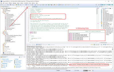

Trying to build and run the S32G274A_Integrate LLCE_CAN_LIN example, following all instructions in the document and due to probably outdated something (some clock divider was not suitable) - I had to run the configuration tool - and here comes the problem
After updateing code in the configuration tool, I saw that the generated files are not generated in the suitable RTD version, they are RTD 3.0.2 as long as the example is RTD 1.0.0
And as so, the compiler says that the versions are different.

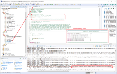

see one example for OsIf.h and OsIfCfg.if

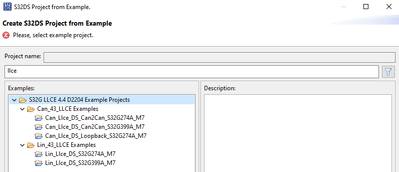

If you already have RTD v3.0.2 with LLCE v1.0.4, we can recommend using the available examples by clicking under S32DS:
Then, under the new window, searching by LLCE as shown below:

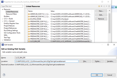

There is a known issue under LLCE v1.0.4, where the LLCE_BIN_DIR linked resource is linked incorrectly.
You need to follow "Project > Properties > Resource > Linked Resources", click the LLCE_BIN_DIR resource:
And modify it to be linked to the correct installation folder of LLCE, which for our specific case is the following:
After this, you can proceed to update the code under config tools. We recommend reading the "description.txt" file attached to the project, since the instructions to be able to run the project are provided in there.
