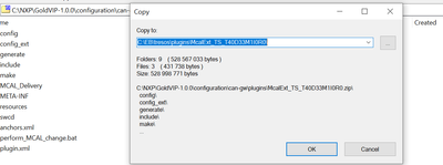

Move to the UM10.4 step 3
Replace the McalExt_TS_T40D33M1I0R0 plugin found in the <EB_tresos_install_path>/plugins/
directory with the contents of the McalExt_TS_T40D33M1I0R0.zip archive, which can be found in the
<GoldVIP_install_path>/configuration/can-gw/plugins directory.
Note: EB tresos needs to be restarted after performing this change, in order to load the newly installed plugins.
A suggestion is to delete the full folder of McalExt_TS_T40D33M1I0R0 contents and then extrac/unzip (please avoid using “drag and place”, do unzip directly like showing below chart) the McalExt_TS_T40D33M1I0R0.zip file into the folder.
