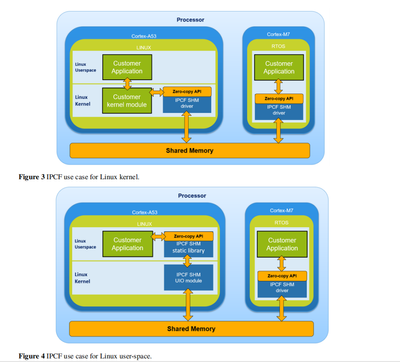

What are the differences and usage scenarios between the two types of usage described in the picture above? Can you introduce them to me, or is there a document description?

As for difference, it seems to be related to whether the application is available within the kernel itself or available under the user-space. As for examples of both scenarios should be provided under the IPCF User Manual [v4.8.0] under Chapter 6.2 "IPCF Shared Memory Sample Application for Linux" (Linux Kernel) and Chapter 6.3 "IPCF Shared Memory User-space Sample Application for Linux" (Linux User-space).
Please, let us know.
