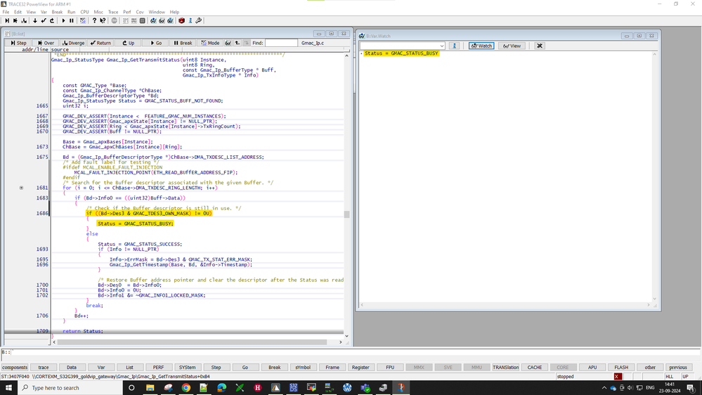

I'm trying to enable Gmac0 controller on M - core and using EB stack, the driver is integrated with the stack, I have not given the reference of eth controller to ethif layer, just for testing purpose I'm calling following API's to test the loopback,
Eth_SetControllerMode(EthConf_EthCtrlConfig_EthCtrlConfig_GMAC0, ETH_MODE_ACTIVE);
Eth_ProvideTxBuffer(EthConf_EthCtrlConfig_EthCtrlConfig_GMAC0, 0U, &BufferIndex, &PayloadBuffer, &PayloadLength);
Eth_GetPhysAddr(EthConf_EthCtrlConfig_EthCtrlConfig_GMAC0, MacAddr);
Eth_Transmit(EthConf_EthCtrlConfig_EthCtrlConfig_GMAC0, BufferIndex, (Eth_FrameType)46U, TRUE, 46U, MacAddr);
Eth_TxConfirmation(EthConf_EthCtrlConfig_EthCtrlConfig_GMAC0);

But the control won't come out of the while loop as transmission is not happening properly and whenever I check TxConfirmation I'm getting error which says GMAC_STATUS_BUSY.
Here Bd->Des3 has some value always and GMAC_TDES3_OWN_MASK is has defined as 0x80000000U so this condition is always true and will always get GMAC_STATUS_BUSY.
I have captured the snips of the EB configuration and prepared a document and attached the same with this ticket.
