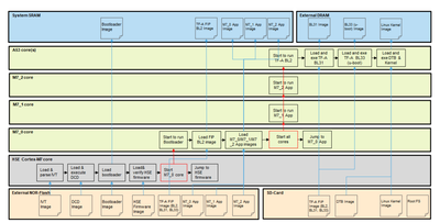

Checking this diagram [Page 3, AN13750 ,Enabling Multicore Application on S32G2 using S32G2 Platform Software Integration, Rev. 0, 11/2022]:
there is a M7 core dedicated to the HSE, this will be taken care of automatically by the chip. This means you don't have to create a M7 program to be able to use HSE on Linux. As you can see in the application notes and examples I shared in my last message, the M7 is not required.
Let me know if this information solves your question
