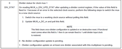

I am trying to generate an clock out of 1MHz on CLKOUT0 on S32G274A with the below configuration but divider configuration update is pending continuously.
MUX_1_CSC : SELCTL -- clk_src_2, FCG -- 0, CG -- 1
MUX_1_DC_0 : DE -- 1, DIV -- 0x27
MUX_1_DIV_UPD_STAT : 1
Please let me know as how to resolve this issue.

Thanks for your feedback. Seen the S32G2 RM, we found the following note [Page 979, S32G2 Reference Manual, Rev. 7, February 2023]:
Which mentioned that if the DIV_STAT bit stays at 1, then the problem might be related to the selected clock source, and 2 steps are shown on how to change if that happens.
As for the configuration the mux itself, we see that Figure 130 and 131 under the RM [Page 1161 & 1163, S32G2 Reference Manual, Rev. 7, February 2023] show the expected flow to configure the CLK switch, we understand that not all steps are being followed under the pseudo-code shared with us.
Can you confirm that following the steps provide a different outcome?

Hi Daniel,
The steps mentioned in Figure 130 and 131 under the RM [Page 1161 & 1163, S32G2 Reference Manual, Rev. 7, February 2023], has supported to resolve the issue.
