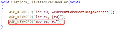

I'm trying to resolve time conflicts in multicore booting S32G399A_RDB3. According to the document "S32G_Supplemental_documentation_on_resolving_clock_conflicts_V1-2023.07.03.pdf", the Bootloader is responsible for most of clock configurations, and I've realized the Bootloader boot atf, but there is a problem when the bootloader boots the M7_0 app. While debugging the Bootloader,  hardfault occured when executing the jump instruction as follows:
if I hit a breakpoint before the jump instruction and execute it in single step I can jump to the reset_handler function of the m7_app without any problem. This confused me.
version information:
1. Integration_Reference_Examples_S32G3_2023_02
2. SW32_RTD_4.4_4.0.0
3. EB tresos 27.1
I made the following modifications to the bootloader:
1. remove Mcu_init in SysDal Deinit List
2. change some clock config in Mcu module to keep the same clock config with atf
0 Replies
