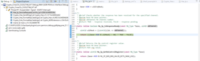

Hi all,
I have some trouble running the Crypto examples comes with RTD3.0.2. My board is S32G274A VNP-RDB2.
For tresos example, I get this error when building the project with "make build" command:
Then I switched to the S32DS example, the project build without problem, but the code stuck here when running:
Please help me out, thank you.

For the Tresos make error, we might need the full log, to see where it is failing.
As for the overall example, HSE FW is required to be able to run this example, as shown below:
Have you installed HSE FW on your board? It seems that you are stuck waiting for the HSE FW to be acknowledged.

Thanks for your reply,
The tresos example build log is attached below.
For the overall example part, how could I install HSE FW on my board? The example description and driver manual seemed to mentioned nothing about it, could you please give me some guide?
I'm using HSE_FW_ 0_1_0_5, downloaded from Automotive Software Package Manager, is this version compatible with RTD 3.0.2 crypto driver?
