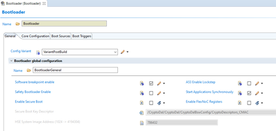

The applications I used under M7 core are IPCF_Example_multi_instance_S32G399_M7_0/1 included in S32G3 software bundle.
The M7 BootLoader creation and configuration steps are:
1. Import the Bootloader_S32G3XX_ASR_4.4_M7 project from Integration_Reference_Examples_S32G3_2023_02 folder into EB;
2. Load configuration, disable Rm item and Rm_Init item in SysDal plugin;
3. Edit boot sources as below:
The reset handler of those boot sources are gotten respectively from the ATF building output, the Reset_Handler keyword of IPCF_Example_multi_instance_S32G399_M7_0.map file and the intc_vector keyword of IPCF_Example_multi_instance_S32G399_M7_1.map file.
4. Configure Boot image fragments of linux_bsp_atf as below:lihongjun_1-1699760376634.pnglihongjun_1-1699760376634.png
The load address is gotten from ATF building output.
5. Configure Boot image fragments of ipc_app_m7_0 as below:
The address is gotten from int_sram_c0 keyword in IPCF_Example_multi_instance_S32G399_M7_0.map.  The size of IPCF_Example_multi_instance_S32G399_M7_0.bin file is 768KB.
6. Configure Boot image fragments of ipc_app_m7_1 as below:
The address is gotten from int_sram_c1 keyword in IPCF_Example_multi_instance_S32G399_M7_1.map. The size of IPCF_Example_multi_instance_S32G399_M7_1.bin file is 768KB too.
7. Configure the boot core as below:
8. Delete project output, generate project, then build the BootLoader by calling launch.bat in Cygwin.

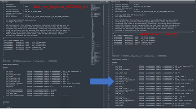

With this we are referring to using the provided linker under the AN13750SW IPCF example, and modify the "Siul2_Dio_ToggleLed_S32G399A_M7" example's linker with it, something as shown below:
If done correctly, your M7_0 source should look as follows under the Bootloader:
This will only be a first step, so that we know it is working.
As for why when only the A53_0 core was enabled it didn't work, we assume that M7_0 core was left unattended (since there was no app linked to it) hence it may have cause the behavior.
Please, let us know.

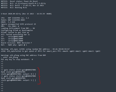

lihongjun
Dear Daniel,
I have tried as what you told, and the LED toggle demo is running (I modified source code to let the blue LED flicker for 1000 times, and it works).
But for A53, u-boot cannot load kernel and always halt after showing "pcie@40400000: RC/EP configuration not set correctly", just the same as before.
I think there must be something wrong during ATF building. Please help me to find the reason.

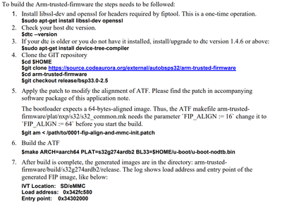

And I have 2 more questions here:
1) Could you please tell me the u-boot source version, the ATF source version, the dtc version and the version of any other components/tools needed by ATF building which are used by your teams for IPCF application on RDB3 board?
2) In AN13750, it says I must apply the patch to modify the alignment of ATF. In fact I just modified the s32_common.mk file and didn't execute the patch command, because I don't know if I must do this for RDB3, and where and how to get the patch. Is it possible that this situation cause the ATF issue?
Thanks.

For the second, we apply the patch only for the 64-bit alignment.

3) Build ATF
A) Install libssl-dev and openssl;
B) Install dtc
C) Clone ATF source code and checkout to bsp35.0-2.5;
D) Edit s32_common.mk file set FIP_ALIGN := 64;
E) Build ATF
make CROSS_COMPILE=/home/lhj/gcc-arm-10.2-2020.11-x86_64-aarch64-none-linux-gnu/bin/aarch64-none-linux-gnu- ARCH=aarch64 PLAT=s32g399ardb3 BL33=/home/lhj/fsl-auto-yocto-bsp/u-boot/u-boot-nodtb.bin
The result of ATF building is:

Given the steps you are mentioning, we believe you have not used the AN13750SW linker, as per our previous description, since the address you show is the following:
And the one that from using the AN13750SW linker should be the following:
Still, we have changed our linker to, as per our current knowledge, be the same the one you are using (the one available under the IPCF_Example_multi_instance_S32G399_M7_0 example). Our result is the following:
DanielAguirre_2-1700160373789.pngDanielAguirre_2-1700160373789.pngDanielAguirre_3-1700160396824.pngDanielAguirre_3-1700160396824.pngDanielAguirre_4-1700160418490.pngDanielAguirre_4-1700160418490.pngDanielAguirre_5-1700160450719.pngDanielAguirre_5-1700160450719.png

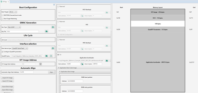

With this, we compile the Bootloader. Create the following IVT:
Where the DCD and QSPI parameters can't be seen, but are the ones provided under the following paths:
C:\nxp\Integration_Reference_Examples_S32G3_2022_06\code\framework\realtime\swc\bootloader\platforms\S32G3XX\res\flash\S32G3XX_QuadSPI_133MHz_DDR_configuration.bin
C:\nxp\Integration_Reference_Examples_S32G3_2023_02\code\framework\realtime\swc\bootloader\platforms\S32G3XX\res\flash\S32G3XX_DCD_InitSRAM.bin
Since we disable HSE under the Bootloader, we do not provide any HSE-FW under the IVT:
Our Bootloader.c file looks as follows (only modifications done to it):
DanielAguirre_9-1700161373605.pngDanielAguirre_9-1700161373605.pngDanielAguirre_10-1700161391309.pngDanielAguirre_10-1700161391309.png
Then flash as per AN13750 explains:
Erase from 0x0 to 0x400000. Then flash as follows:
  • 0x0 -> Blob of the IVT shown previously
  • 0x100000 -> fip.bin
  • 0x200000 -> Siul2_Dio_ToggleLed_S32G399A_M7.bin (where Reset_Handler address is 0x34100010, this can be confirmed under the *.map file)
With this, we are able to see the LED (under PA_06) being toggled under uboot and see the full Linux boot (when the Linux boot starts, the LED stops toggling, since we did not reconfigure anything under the Linux DTB):
The full log will be attached to this post.
At the end, we understand we are following your setup, as per our current understanding, and can see both cores running no problem.

As for the test I provided before, I only applied the FIP_ALIGN patch to be equal to 64. After that, I build the uboot and ATF as per AN13750 (with the branch set to BSP35.0, without the mmc patch, the platform to be RDB3 and the links to the github repository instead of CodeAurora).
DanielAguirre_0-1700236778895.pngDanielAguirre_0-1700236778895.pngDanielAguirre_1-1700236805741.pngDanielAguirre_1-1700236805741.png
With that, we are seeing the correct outcome from our side.

When ATF is checked out to BSP33-2.5, the fip-align-and-mmc-init patch can be added, the board can bootup, and kernel can be loaded when I input boot command at u-boot prompt. The LED toggling will stop when kernel start running. This is just the same as you notified before.
But when ATF is checked out to BSP35-2.5, the patch cannot be added and show "Patch failed at 0001 fip-align-and-mmc-init". So I have no choice but to edit the s32_common.mk file and change FIP_ALIGN t0 64 manually. But under this condition the u-boot will halt after showing "pcie@40400000: RC/EP configuration not set correctly".
If I have to configure the boot loader and let it to initialize all clocks to solve this issue, could you please tell me what to do in details? For example, you can give me a document or snapshots including the values of McuClockSettingConfig of MCU plugin of the boot loader, or something else which can show me what to do.
Thanks.

Thanks for your feedback. For the behavior that you are seeing and the conditions in which you are seeing it, we understand that your base image is using BSP33.0, not BSP35.0.
For using BSP35.0, you need both ATF/uboot version to be BSP35.0 and the base image (*.tgz file) being also BSP35.0. Mixing versions bring unpredictable results, which seems to be the ones you are seeing.
Again, since BSP33.0 ATF is working for you, we understand that your base version (*.tgz file) is also BSP33.0. Can you help us share a full boot log of your working setup? For us to confirm this situation.
