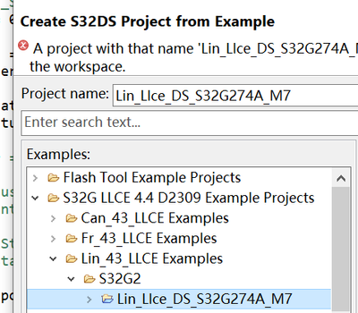

May I ask about LLCE_ An example of communication between master and slave nodes related to lin, for example, when the master node sends a complete frame and sets a specific slave node to receive this response, is there any relevant source through this example? I would greatly appreciate it, and besides, I am in that Lin_ Llce_ DS_ S32G274A_ In the M7 case, there was no real operation found regarding the reception and response of the slave.

Looking into the available information on regards of the LIN Loopback DEMO for LLCE, we see the following information:

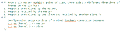

Also, the following is told under the example:
For which, the LIN functionality should be implemented for both functionalities.
Again, we apologize for any misunderstanding from our side.
